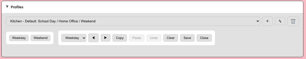

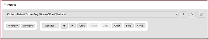

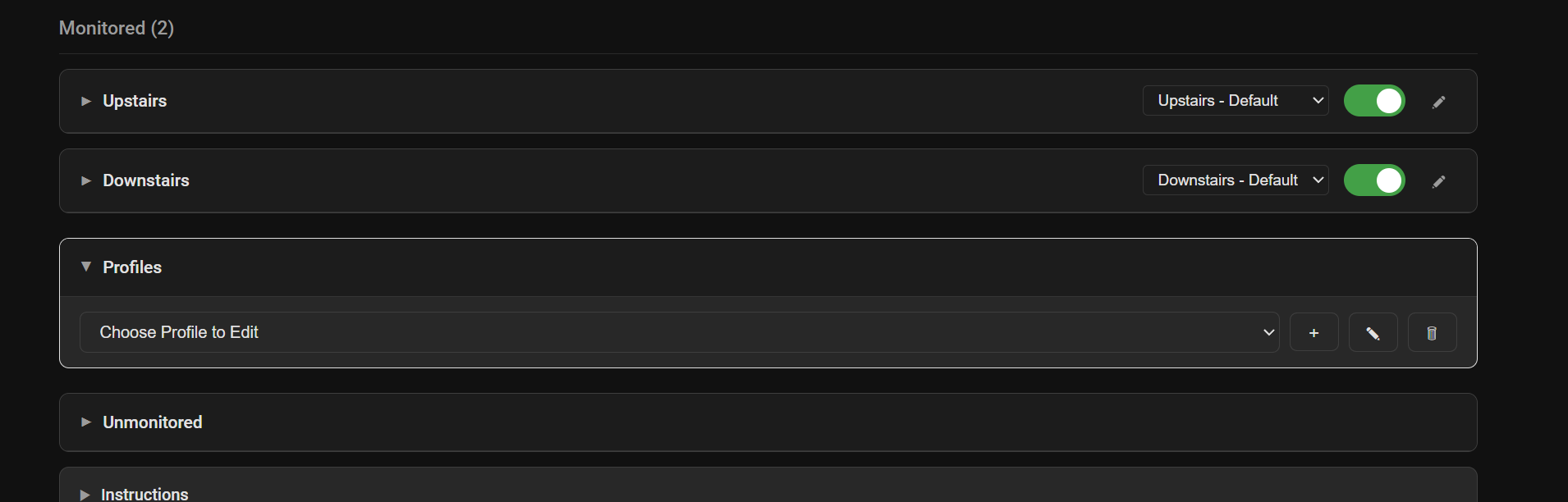

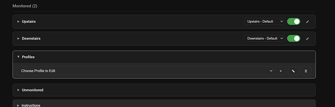

Just to confirm, are you seeing the profile editor in its new location?
Interesting… no I’m not…

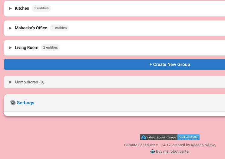

The version tag at the bottom is also still the old one.
I have updated and restarted HA.
Profiles have been renamed as you announced. Just reloaded the integration and restarted HA again - no change. Still can’t see the profile editor where it is in your screenshot.
I reinstalled version 1.15.0 and restarted, now I get the same picture you have. Back testing now. No idea where and why that got stuck the first time around. There was nothing in the logs.
