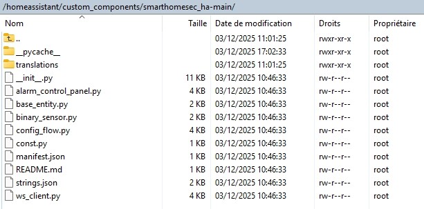

I have the error message :
Configuration flow cannot be loaded : {“message”:“Invalid handler specified”}
Here is the log :
2025-12-03 17_45_13-Paramètres – Home Assistant — Mozilla Firefox
I seems that config_entries.py is missing …
Here is the installation :
Try renaming the folder inside custom_components to smarthomesec
Cool, it worked ! And I also tested and it works fine with detectors. Many thanks ! Great integration for Vesta users. Because you can also use Vesta sensors status to switch on a light or do a notification, even when alarm is disarmed. With SIA, it is impossible to do that, it works only when alarm is armed.

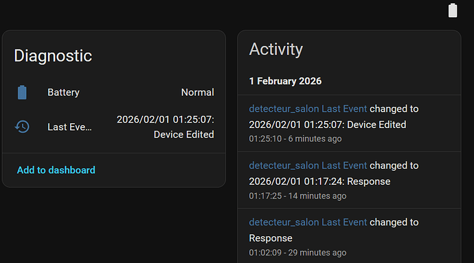

Regarding Motion Detectors, the integration currently provides a Battery sensor (binary… ). I’ve also implemented a Last Event’ sensor for each device; this allows you to track specific logs and triggers even when the device status doesn’t change state in the main table :

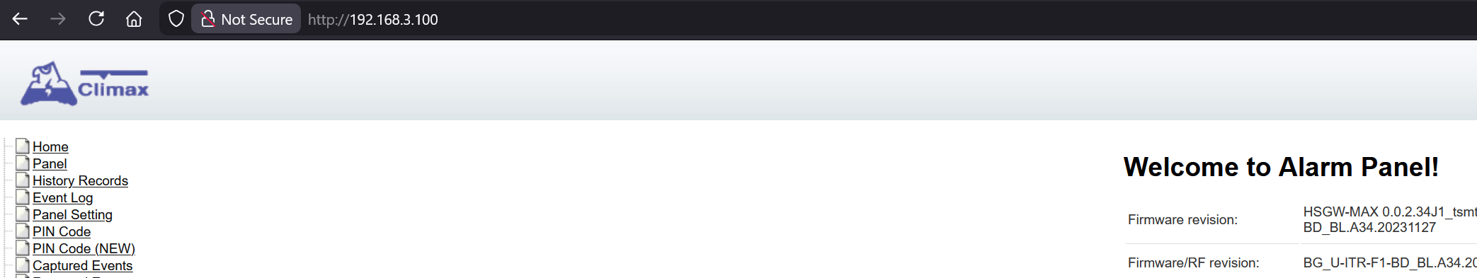

Thanks, but actually, it seems I have not access to the local API :frowning:
The endpoint always return empty responses. Maybe the endpoint is not available on wifi, only ethernet?
I’ll check with the installer during the yearly checkup…
Oh :frowning:
I can connect to the local interface using wifi (same network ofc).
Maybe the issue is caused by the basic auth or the alarm model.
What is your model ?
I currently use this one: HSGW-MAX
