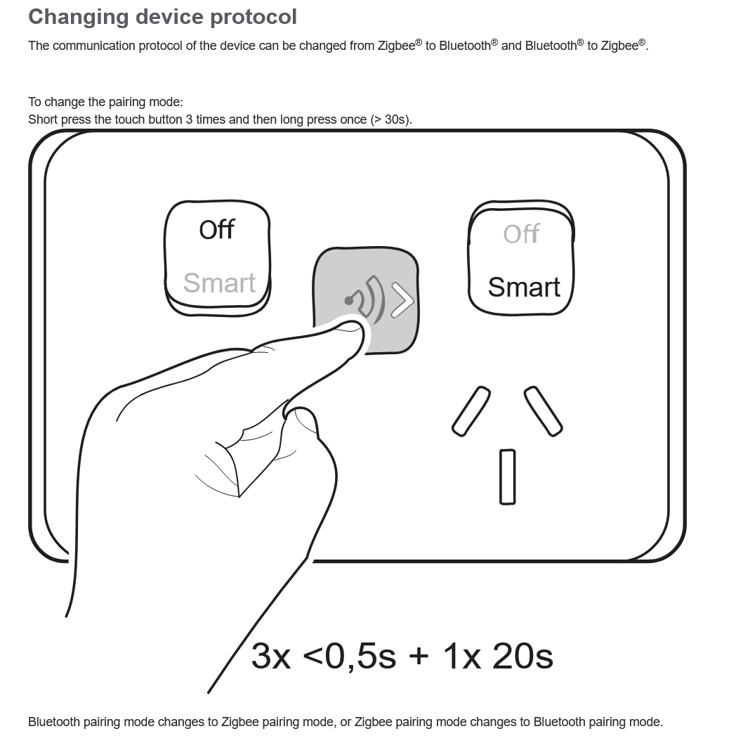

Anybody successfully paired the Smart GPO? I cant get it to change from BLE to Zigbee
I don’t have one, but here are the instructions to change the protocol:
from: https://www.productinfo.schneider-electric.com/clipsal/wiser-iconic-connected-twin-10-a-socket_device-user-guide_clp/English/Wiser%20Iconic%20Connected%20Twin%2010%20A%20Socket_Clipsal_Device%20user%20guide_0001066126.xml.
Yes you can.
With Zigbee2Mqtt
I have found it tricky to do, follow the instructions and dont give up!.
I sent ~2 hours getting one paired
Thanks. As per my edit, I found a way using ZHA Toolkit.
