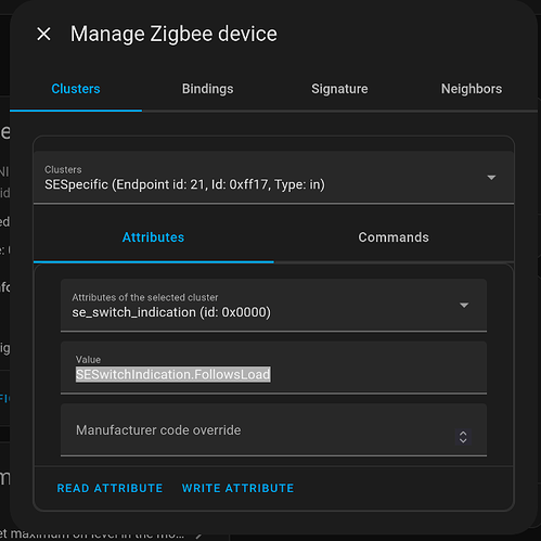

You can do it by clicking on “Manage Zigbee Device” on device page, selecting SESpecific cluster, se_switch_indication attribute. There you can use the following values:
  • SESwitchIndication.FollowsLoad
  • SESwitchIndication.AlwaysOn
  • SESwitchIndication.InverseOfLoad
  • SESwitchIndication.AlwaysOff
I’m planning to add this setting as a dropdown for ZHA soon.

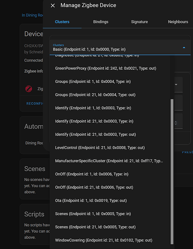

I just went looking for this for one of my 2AX switches and the SESpecific cluster does not exist:
These switches actually get detected as Lights by ZHA so I have reconfigured them as switches in my configuration.yaml, as follows:
zha:
  device_config:
    ieee#-1:
      type: "switch"
Is there a reason why ZHA doesn’t automatically add these as switches?
Your switch model is probably missing in the list of supported devices here:
Could you create an issue on zha-device-handlers with you device signature?
