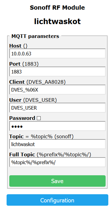

This is my configuration on the tasmota device.
