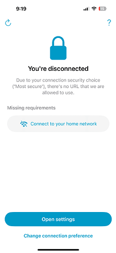

HA Green with Cloud subscription. Remote Access setting is enabled. “Most Secure” setting selected which was recommended. I’m getting the following message when I leave my home:
Due to your connection security choice (‘Most secure’), there’s no URL that we are allowed to use.

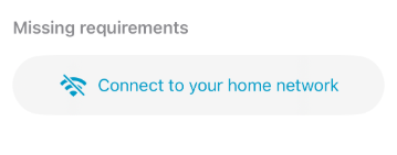

Missing requirements
? Connect to your home network
I am unclear how to correct this and can’t seem to find an answer. Anyone know? Thanks!

Can I expect to access it remotely through the iOS app? The app shows the image I screenshotted and attached. I haven’t seen that url you posted until now.

The screenshot above is directly telling me that I’m disconnected due to my security settings.

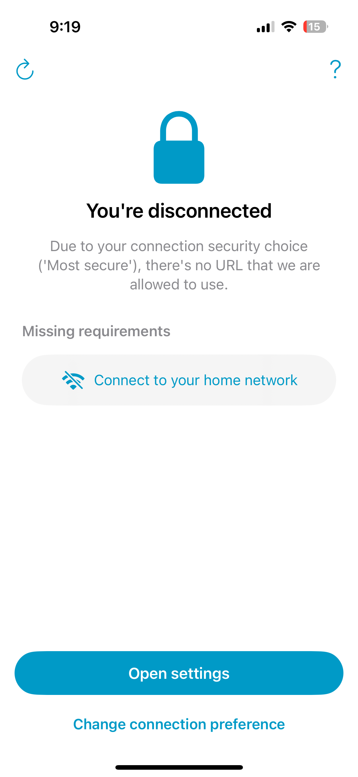

Getting the message in the screenshot attached.
I don’t see a way to resolve this. Any ideas?

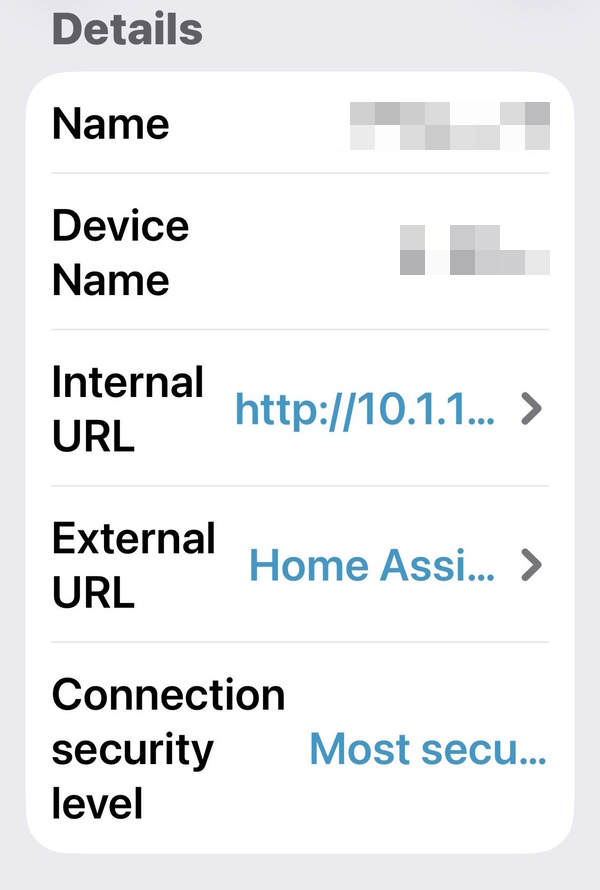

It does not look like it can connect to your local network to obtain your cloud URL from Home Assistant.
While at home on your local network, in the app:
Settings → Companion App → Your server (top section), check the internal URL is correct.
External URL should be Home Assistant Cloud (no URL required).
You also need to go to Settings → Home Assistant Cloud and switch remote access on there.
You can also copy the link from there and use it in the app’s external URL settings (turn the cloud switch off in the External URL section and specify it manually) as a last resort if you cant get the internal URL working.

Thank you again for the help, I just wanted to follow up and let you know that when I did visit my settings page I was surprised to see that my security level was not on the correct setting like you have in the screenshot above. When I changed that, I believe it clarifies when I am home versus away and now it is working correctly where I can access remotely through the app.
