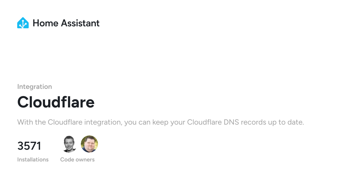

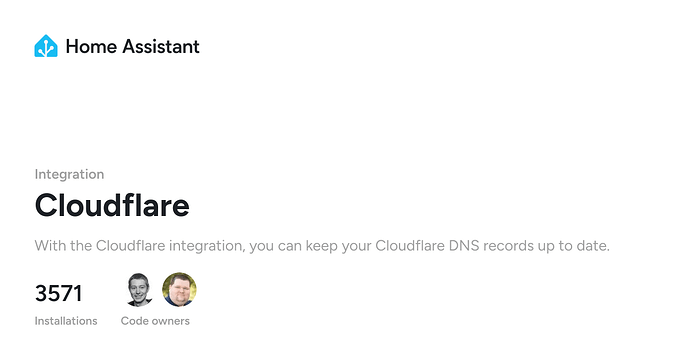

Only doc I could find was this and there is not much there…
