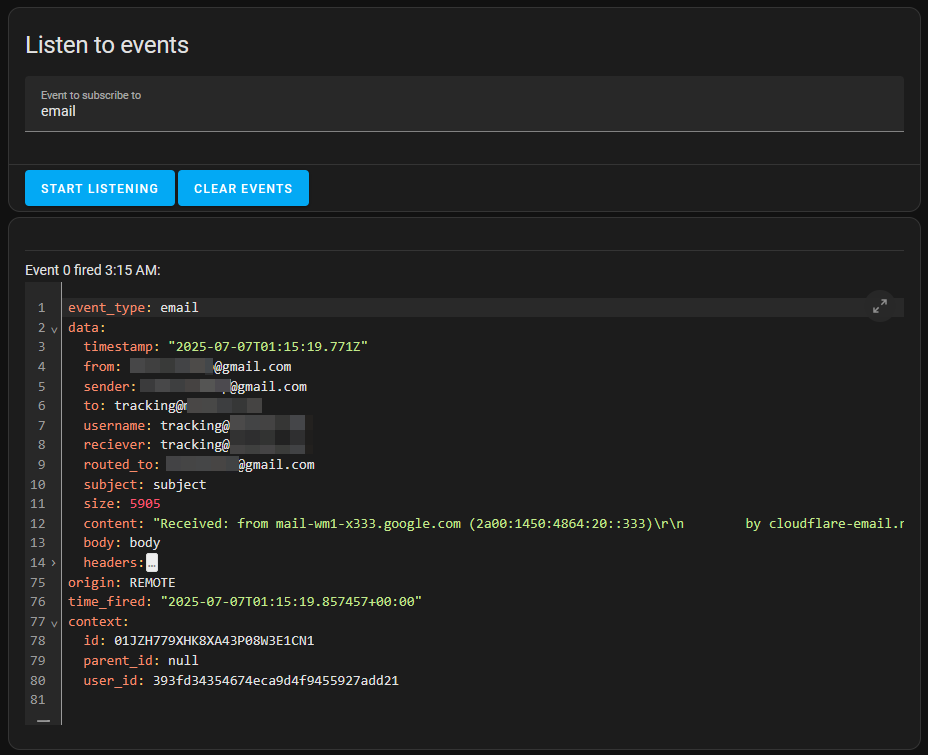

Wanted to share the cloudflare email worker i made to stop using the IMAP integration for constant polling that can be created via the cloudflare dashboard and then set for the catch-all address. Sadly normal routing addresses need to be disabled for it but theres a dictionary in it that handles forwarding/dropping certain addresses.
Cloudflare Email Worker JS Code:

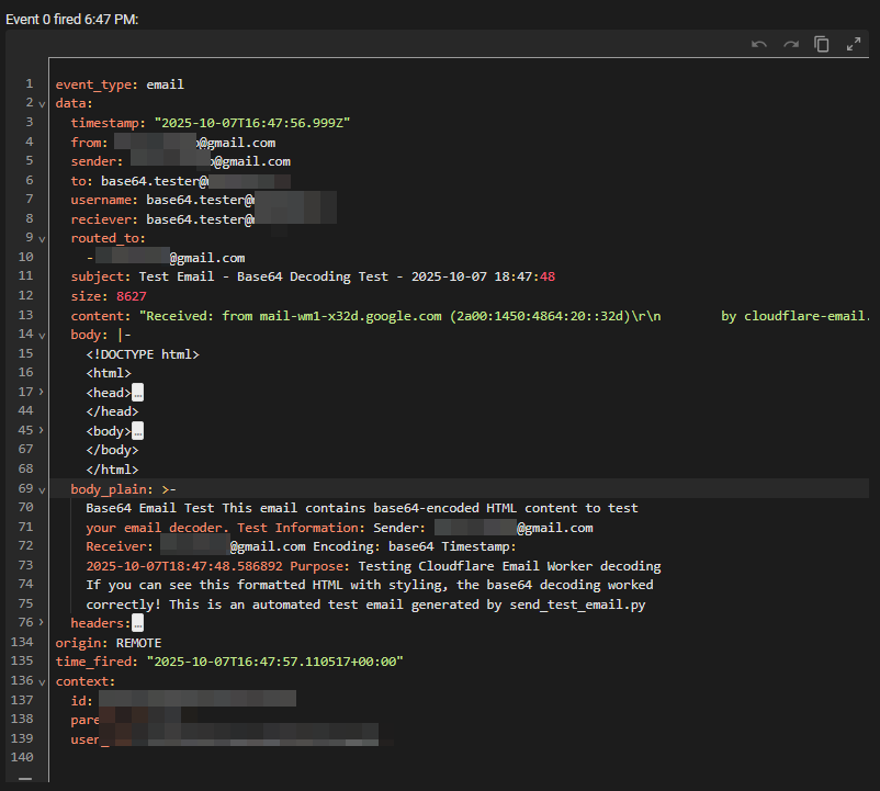

 * Decode base64-encoded email body if detected
 * @param {string} rawContent - The raw email content
 * @returns {string} Decoded body content
function decodeEmailBody(rawContent) {
  const body = splitOnSecondLastDoubleNewline(rawContent)[1]?.trim() || "";
