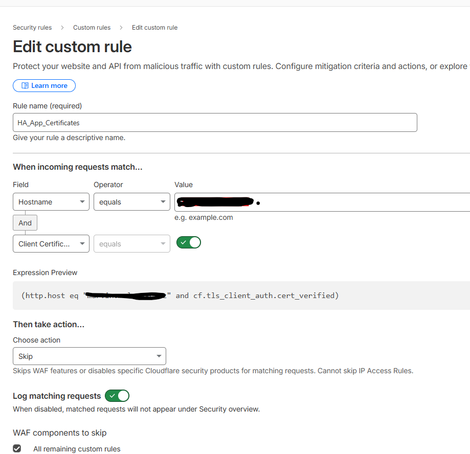

I have had a tunnel running in my network, not the HA add on, from which I have had access to my HA by zero trust email verification.
Based on this I tried to get the app to work (when not on VPN).

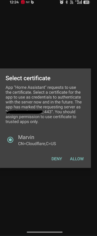

I created a certificate uploaded it. When starting the companion app it asked for the cert to use.

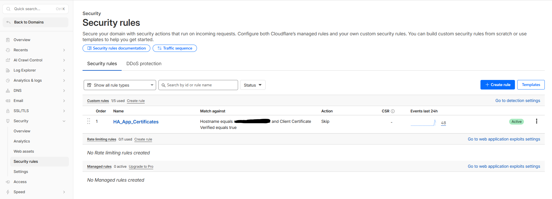

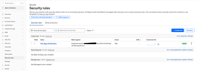

And the created rule gets hit with the certificated connection:
rule:
Hits:

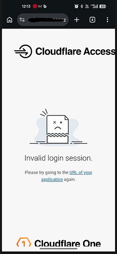

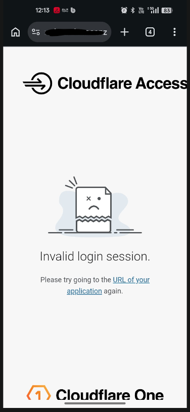

But HA stays blank and it keeps it keeps opening the broswer to display Cloudflare is refusing access:
Witin zero trust I tried adding additional policies allowing wth validated certificate but it makes no difference, and it won’t let me create a bypass rule based on a certificate…
I know I can still use the app when my VPN is on as it used the local addressbut it would be nice to get it working and I am running out of ideas…
