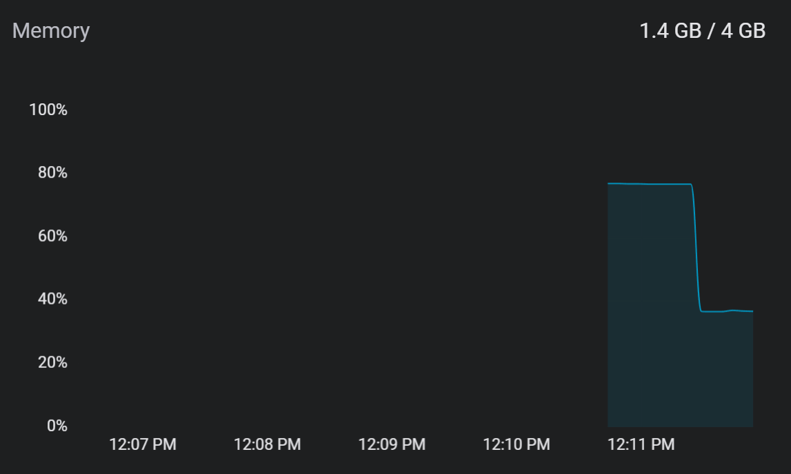

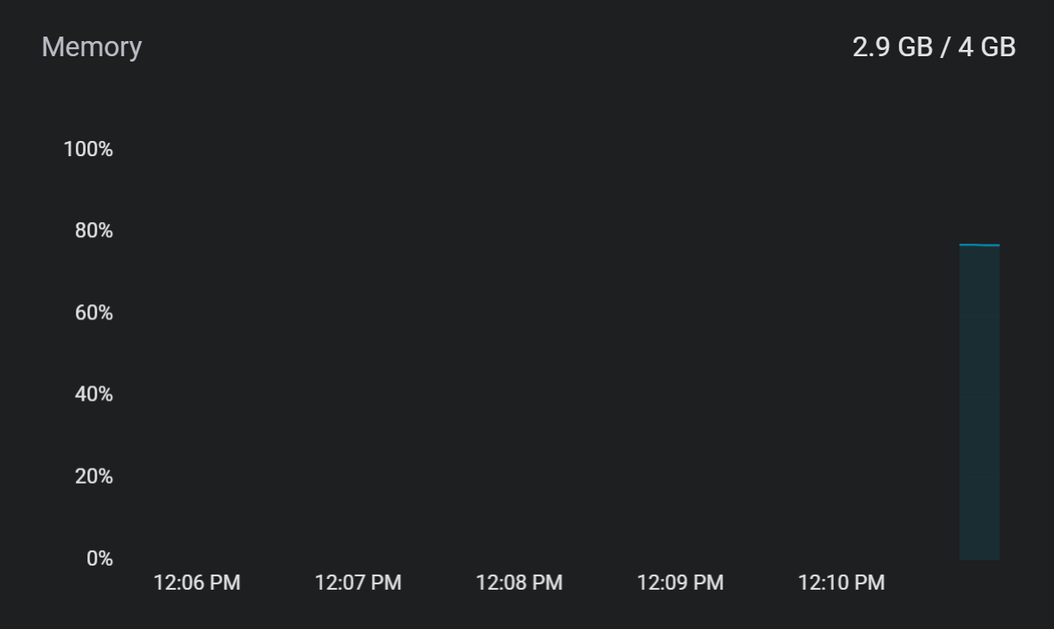

Fair enough. I run it on a 4GB of ram VM. It doesn't max it out but definitely uses more ram than any other app/integration.
While running Code Editor
After stopping Code Editor
The original VSCode seemed to be leaking memory with use or something like that, leading to what Taras experienced, even on a 16GB NUC. So I'm b bit reluctant too. When I have time and courage....

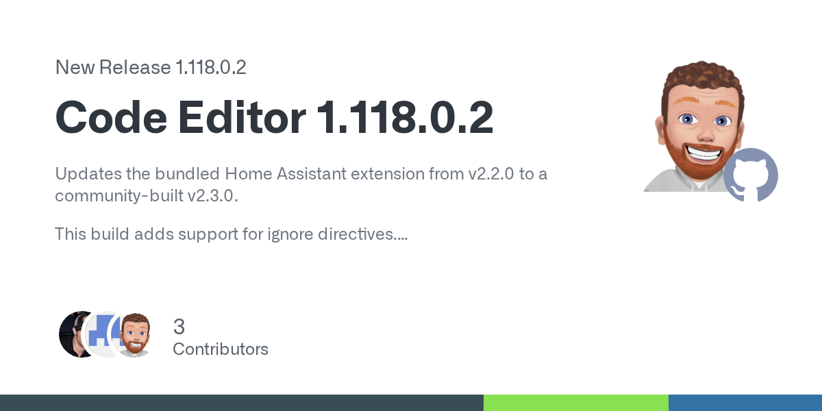

I was able to build the extension with the PR to support ignore directives. Extended a bit beyond the PR I linked as it didn't allow ignoring yaml-schema errors. So far, the new code-server app is working great. Thanks for making this!
sweet! Can you share the .vsix file? I can build it into the installer for Code Editor.
I sent you a DM with the link to the updated extension. The link is good for 14 days.
Done

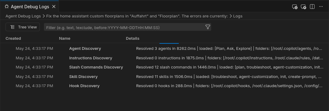

Thanks for that add-on, I really like it so far. Only issue I had was that the Copilot coding agent is not working. I could sign in just fine but the prompts I send get stuck every time.
After submitting a prompt, the text "Activating MCP extensions... Skip" appears which I skip as I don't need them (I tried waiting for it to complete, never happened...).
Then, "Working" appears, which never completes / does anything.
The "Agent Debug Logs" only show this:
