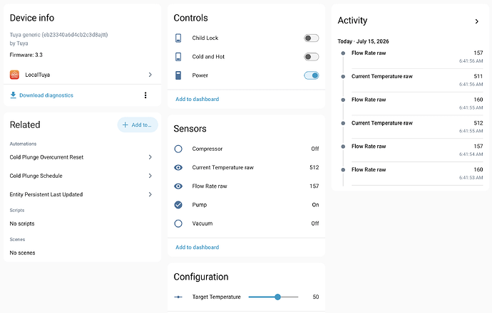

I wonder if I have the same chiller as you - I had to create a developer account with Tuya and try to figure out all the mappings (I even unlocked the heating ability).
Just in case it’s useful, this is what I mapped using the LocalTuya integration (GitHub - xZetsubou/hass-localtuya: 🔹 A Home Assistant integration to handle Tuya devices locally "fork from localtuya" · GitHub) edit to add - this integration gives you local control
SWITCH 40 Cold Plunge Child Lock
SWITCH 121 Cold Plunge Power
SWITCH 115 Cold Plunge Cold and Hot
BINARY_SENSOR 122 Cold Plunge Compressor
BINARY_SENSOR 126 Cold Plunge Pump
BINARY_SENSOR 128 Cold Plunge Vacuum
SENSOR 29 Cold Plunge Current Temperature raw
SENSOR 102 Cold Plunge Flow Rate raw
NUMBER 17 Cold Plunge Target Temperature

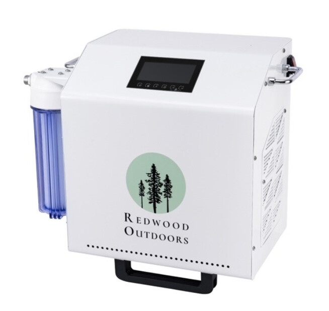

My unit looks like this:
