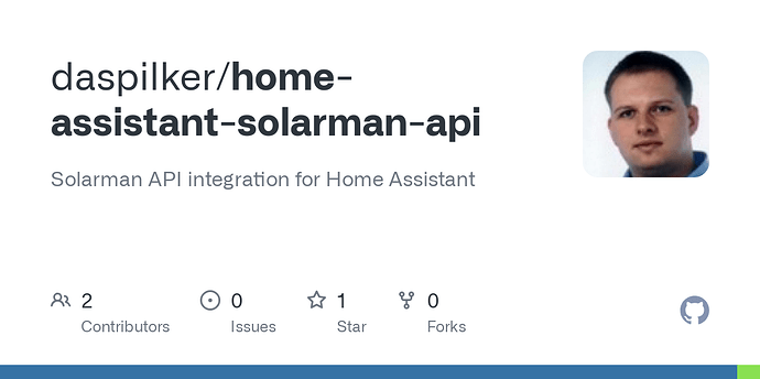

Hi everyone!
I created a custom integration to collect the data from the API:
Works for me, but give it a try if you are interested. I will see if I can integrate any feedback.

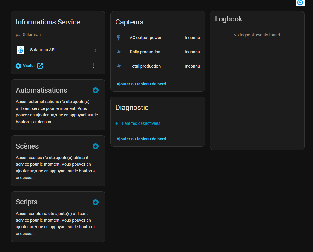

Bonjour Daspilker, j’ai ajouter ton intégration et je ne comprend pas sa me marque dans la case diagnostic 14 entité desactiver?

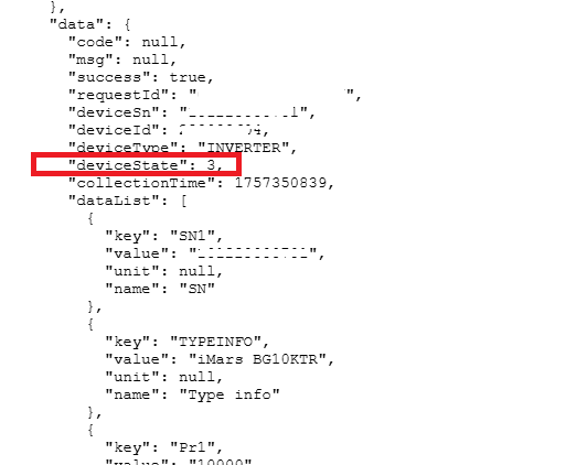

Hi Daniel Im experimenting with diagnostic file. I want to create another entity of Inverter state. It is possible?

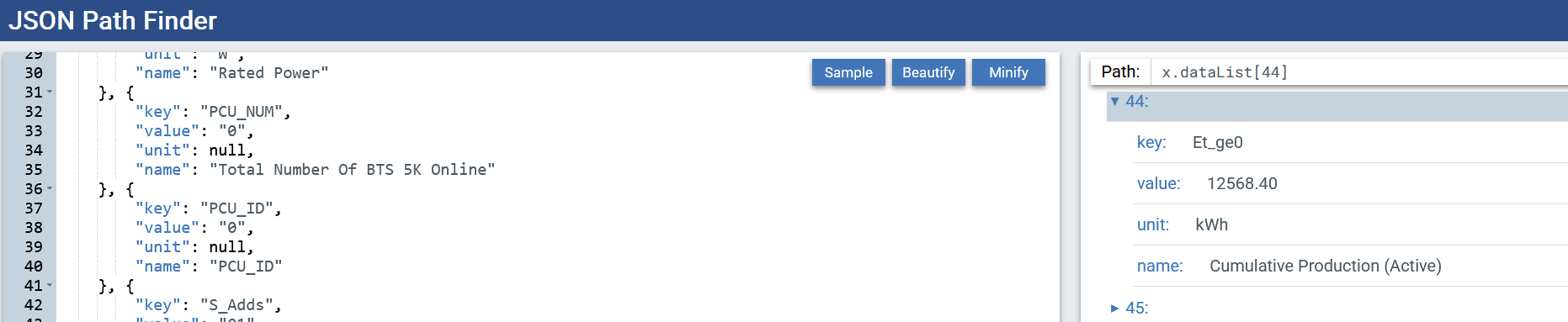

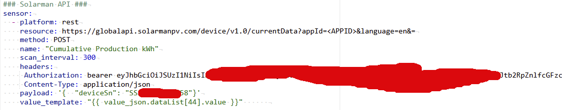

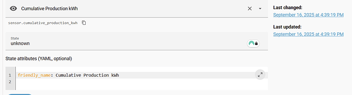

I’m stuck I think at the last hurdle.
I’ve got the key from Solarman and can get to the data using https://reqbin.com/curl so I know I have access.
I can see the path and value in json path finder.
But…I can’t get HA to get and/or display a value.
I feel this is a formatting issue with how I’ve set up configuration.yaml
Sage guidance needed please…
think you might be missing the actual dataList/json_attributes in your sensor…so everything is working as you have it set up but you are not actually bringing in the dataList anywhere…
add this to your template and you should be up and running
(add it in line with headers and payload:)
json_attributes:
      - dataList

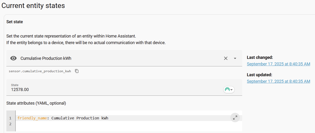

Isn’t that in the last line of my configuration.yaml. ?
No, that’s just a single value you are showing in the sensor…if you want to bring back all of the data from the API you’d either need multiple sensors or to capture it into the attributes of this sensor (and then split out the values you want to see using more template sensors)…that’s what’s working for me anyway

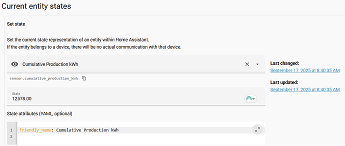

Got it! Some of the posts above show the token wrapped in " or ’ in configuration.yaml which is what I’d done. Removed these and ta dA!
Now off to add all the other sensors.

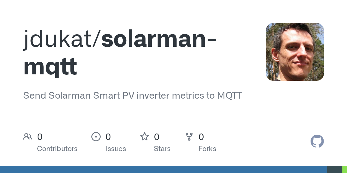

I’ve tested multiple versions of solarman-mqtt repos (the original one and forks), but all cause some kind of problems for me.
Main ones are:
  1. my inverter returns status 128, which the tool treats as incorrect, but it’s actually fine and working correctly
  2. with above fixed, I see some MQTT messages being dropped when the script is run with -s option (single run: probably the script exits before the network buffer flushes)
  3. the mqtt and template definitions are obsolete and require some polishing
I fixed all 3 above and published here:
If I have some time, I’ll try to package it into HACS, but that won’t be quick.
