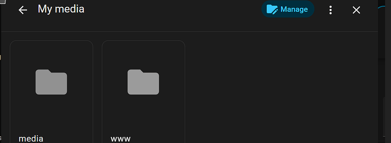

If you want to use the WWW folder to store media, this is the way
1) Map your folder in configuration.yaml
If your image is in /config/www/proxy/…, map that folder (or the whole /config/www) under media_dirs:
# configuration.yaml
homeassistant:
  media_dirs:
    local: /media                       # keep default
    www: /config/www                    # exposes ALL of /config/www
    # or, if you prefer just the proxy subfolder:
    # proxy: /config/www/proxy
Then Restart Home Assistant (or Developer Tools → YAML → Reload core configuration if offered). This makes your folder appear in the Media Browser and gives it a media-source name (www or proxy). Home Assistant
