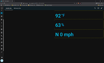

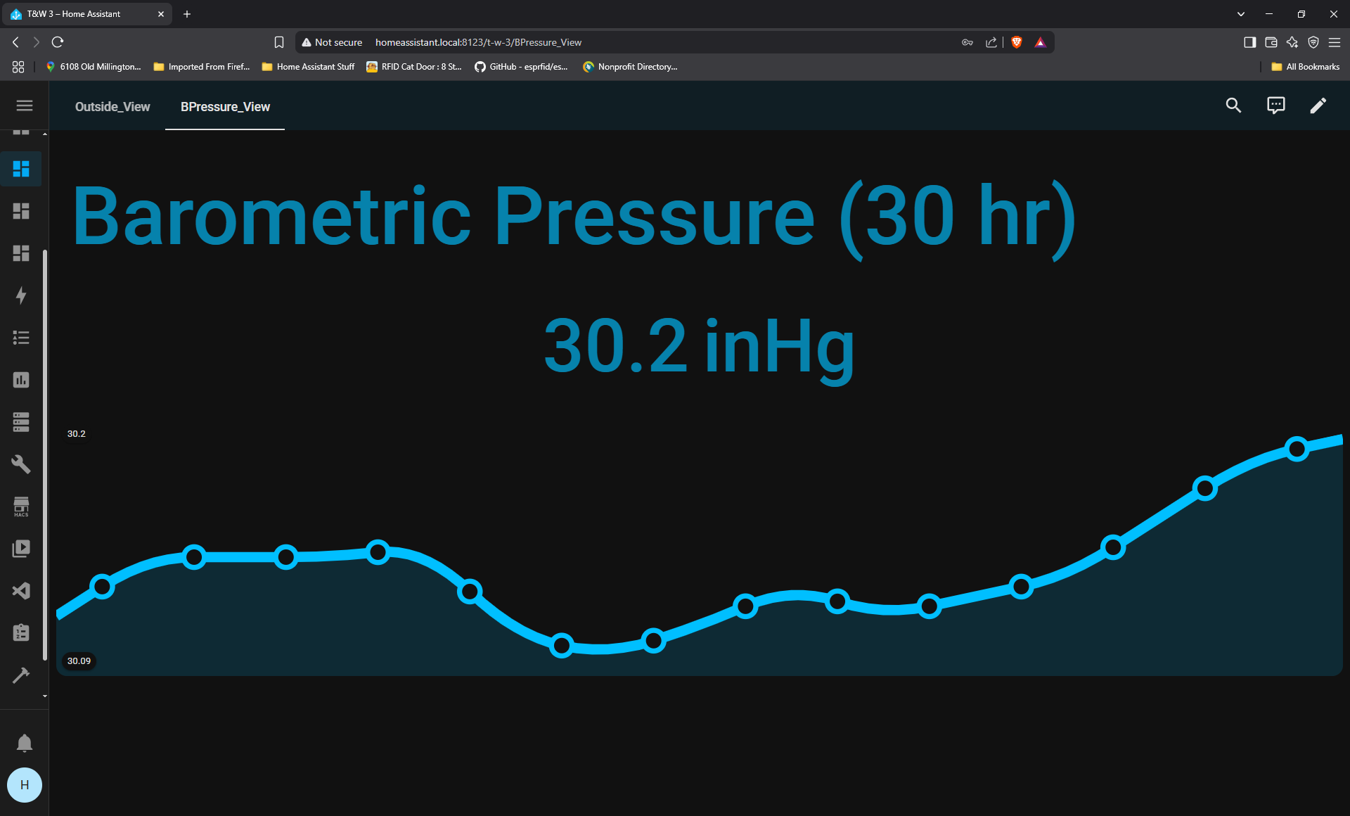

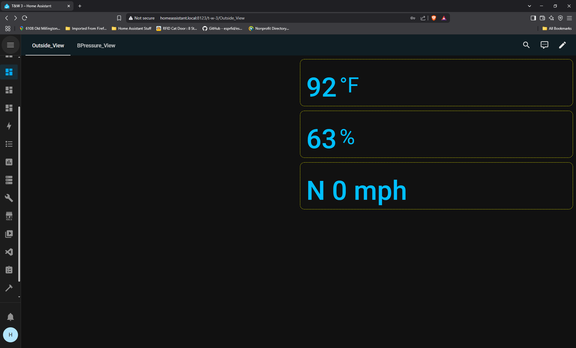

Screen shots
In this view, the color is correct (DeepSkyBlue)
In this view, the text color is not the same as the above view even though it is specified as the same color. The line color however, is correct.
The code still contains stuff which just distracts like layout-card & plenty of unrelated card-mod code.
But anyway, you will not get SAME color since these elements in mini-graph-card have an opacity set. Use Code Inspector (or whatever it is called in your browser) to find out a proper way to style.
OK, so the Code Inspector suggestion actually helped. By poking around through the elements I was able to find one which was apparently overriding the opacity I specified. I’m guessing that’s the “cascading” part of CSS. Fixed the issue by adding “.ellipsis” to the .header .name element on the mini-graph card as follows:
            .header .name .ellipsis {
              color: deepskyblue;
              opacity: 1;
              font-weight: 500;
              font-size: 6em;
Then the color rendered as I intended.
