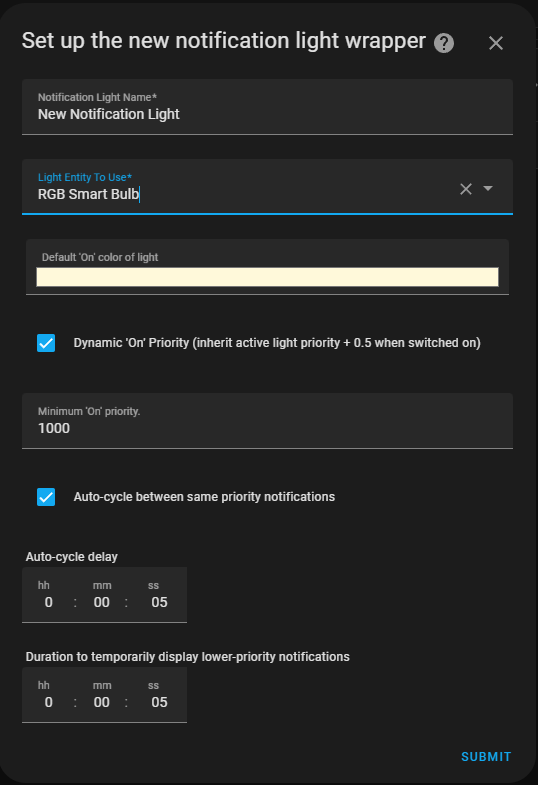

1. Wrapping a Light
When you first wrap a physical light, you get to choose how it handles manual overrides and priority ties.
As you can see, it's just quick checkboxes for things like Dynamic 'On' Priority and Auto-cycling.

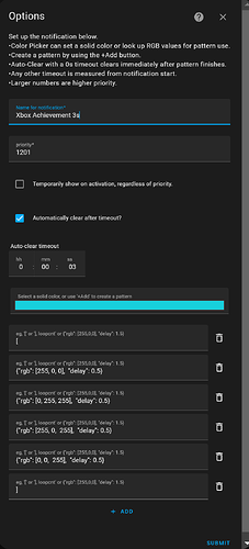

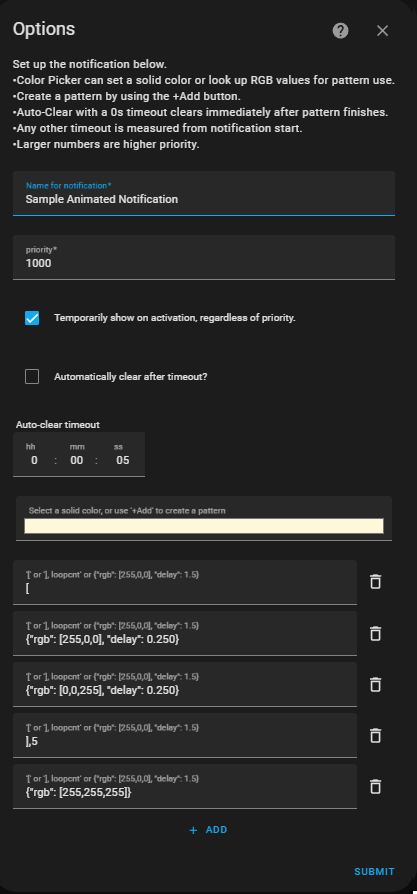

2. Creating Alerts and Patterns
This is where you build out your notifications inside your Pools, setting your priorities, auto-clear timeouts, and light colors.
If you check out the Pattern field in the screenshot above, you can see how easy it is to write a looping flash using basic colors and delays (e.g., {"rgb": [255, 0, 0], "delay": 0.5}).

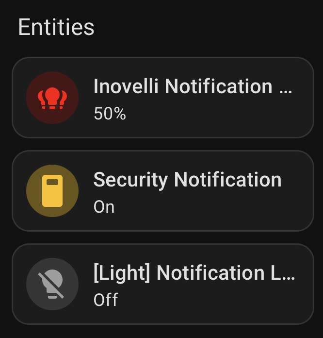

Just came across this and its already proving to be an incredibly useful app. Thanks for the work on this. I’m using it with these Matter switches: Inovelli White Series 2-1 Smart Switch • Works With HomeKit • Matter which allow the RGB LED bar to be controlled like a RGB bulb to display notifications.
I’m glad you are finding it useful! Thank you for the comment, it’s always encouraging to hear that someone else is benefiting from the effort put into it (and gives me more motivation to put more effort in)

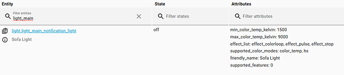

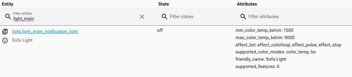

Hi
Toggle within ESPHome is no longer working with this light - I am guessing a HA change has caused the state to no longer be reported correctly - but just a guess! Any thoughts?
I noticed with my notify light on or off, the state in HA is reported as off… maybe this has always been the case?
I’m not completely sure I understand the exact situation, so I’m going to answer what I think you are asking, but ask again if this doesn’t apply :slight_smile:
If the light in the screenshot is the Color Notify ‘wrapper’ light, and you are saying that it is showing a notification but shows ‘off’ in HA, then that is the correct behavior (unless you turned the wrapper entity light itself on…)
The wrapper presents itself as a normal light and hides anything the notifications are doing. You can look at the ‘real’ entity to see what the light is actually showing, but the wrapper entity should look like it’s just a normal light bulb without any of that hidden notification stuff happening.
edit: Ah, just saw the github issue, let’s move this there.
Thank you, and solved by looking at the HA original light state… thanks for your help!

The created ‘wrapper’ light entity is supposed to act like a normal light bulb and hide all of the notification stuff. Once you create a wrapper light you should no longer directly interact with the ‘real’ light entity. You should only interact with notification switches or the ‘wrapper’ light entity.
The idea is that you treat the wrapper light as a normal light. You can turn it on, you can turn it off, you can change its color. It just transparently shares the ‘real’ light between this fake light and all of the notifications assigned to the light.
Each light has a ‘default on’ priority that you can specify. If multiple notifications are active (or you have the light ‘on’ and have a notification) then the real light will only display the highest priority item. So if you had a notification with priority 1000, and a light with priority 900, then if you switch on the light AND the notification then the notification will show on the real light since it is higher priority than the ‘on’ light.
This is where dynamic priority comes in. If dynamic priority is enabled then when you turn ‘on’ the light its priority will be the greater of the light’s default priority, or if there any notifications active then the lights priority will be just barely above the active notifications priority.
If that’s confusing, consider this scenario:
  • My entryway hallway has an RGB light that has many notifications assigned to it.
  • The light switch in the hallway toggles the ‘wrapper light entity’ when it is switched
  • My wrapper light has priority 1000
  • A notification with priority 2000 is currently being displayed
If I walk into the hallway and flip the light switch, the wrapper light turns on but it is lower priority than the notification, so the notification wins. Nothing happens when I switch the light switch.
With dynamic priority, when I flip the light switch the wrapper light is temporarily given priority 2000.5. I just flipped the light switch, I expect the light to turn on regardless of if there is a notification or not. The light will keep this priority until it is turned off.
