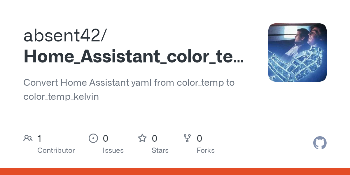

Color_temp to color_temp_kelvin migration tool
Home Assistant 2026.3 has removed color_temp (mireds), kelvin , min_mireds , and max_mireds in favor of color_temp_kelvin
Here’s a small tool to copy/paste your yaml into, and it’ll attempt to automatically replace the depreciated constants to their new versions along with the corresponding converted values.
