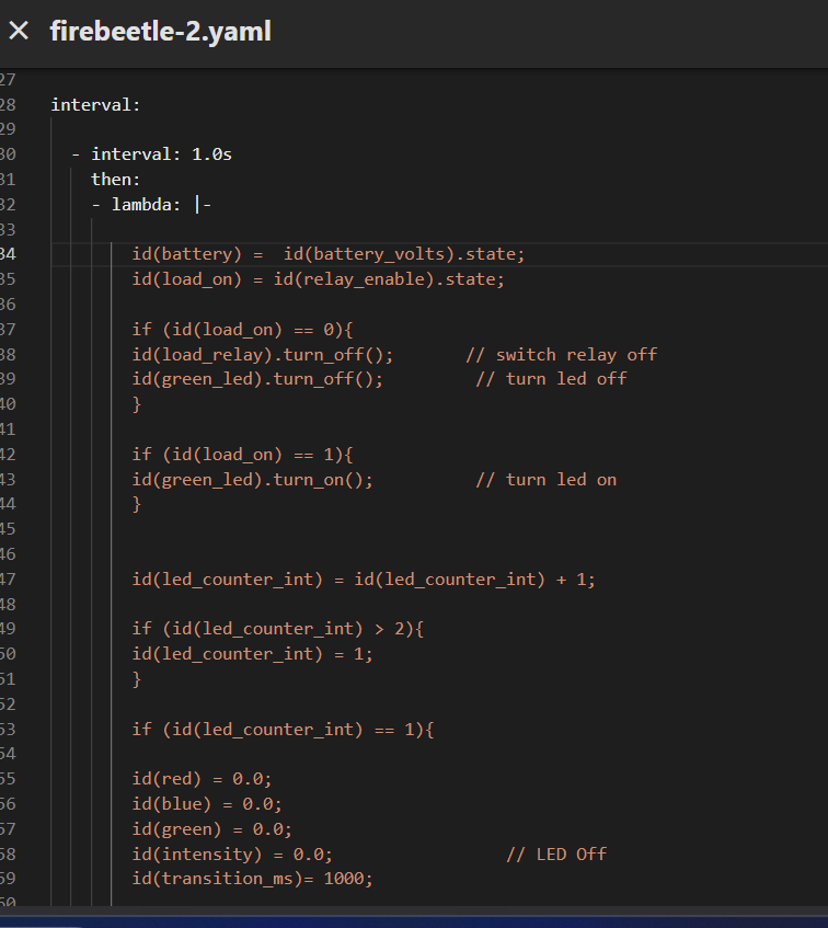

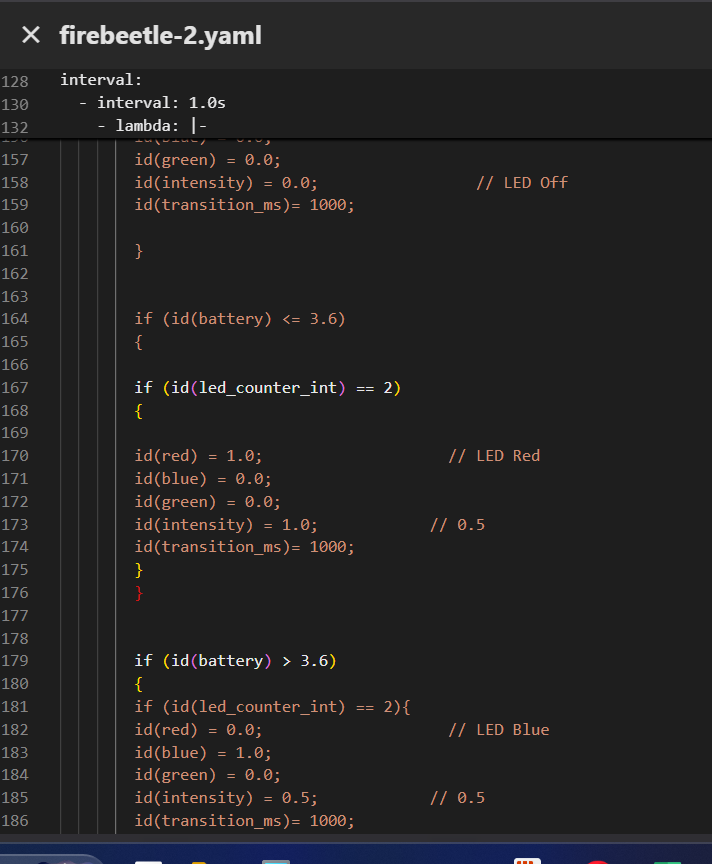

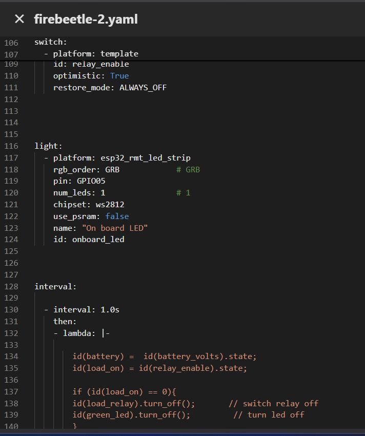

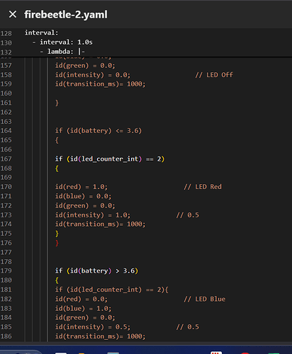

In one of my ESPHome projects, the yaml file started off looking as normal, but somehow became colourful in a way I don’t understand. Can anyone explain why these colours have appeared in the lambda section?
Then it turns to white at the end…

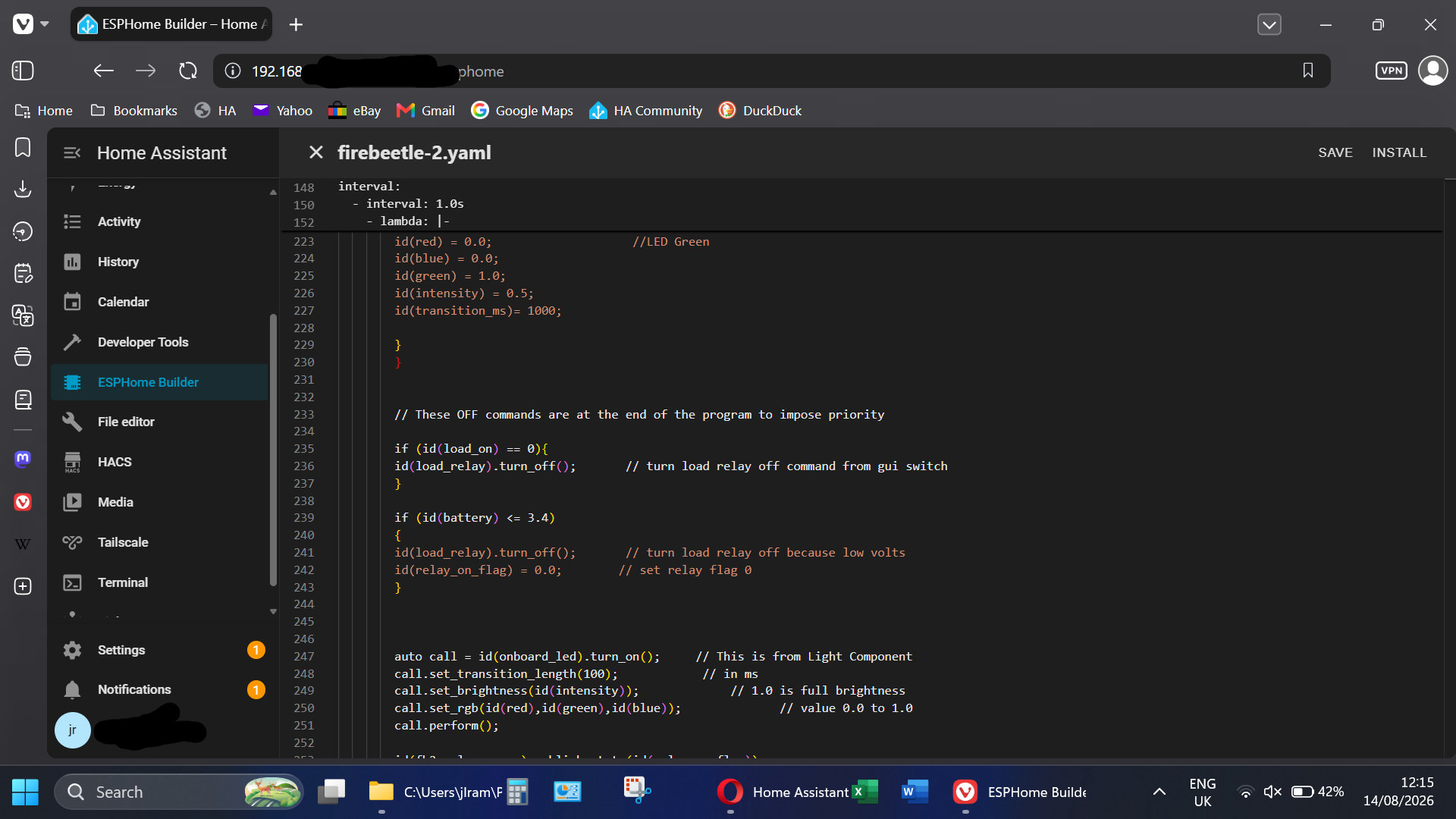

I’ve had to include pictures of this as posting the yaml in markup brackets, as above, doesn’t show the colours seen here:-
It’s not causing a problem, I just don’t understand why it happened, or how to put it back to ‘normal’. Or maybe this is normal, and the start block which is a brown/red is not correct?
It’s VSCode’s syntax highlighting. It is used to make the code more readable.
Why would it appear is some places and not others in the same project?
How did it get there?
Why doesn’t it show up when pasting markup code here?
The colour depends on what you have written. e.g. VSCode is not good at syntax highlighting inside braces or quotes.
The colours are not part of the file. They are applied when you view it and it depends on what is showing it. The forum has its own syntax highlighting. It is not the same as VSCode.

Because the code that does the coloring can’t follow the code correctly. The color is messed up well before you noticed it. (Some of the braces } are colored red, which usually indicates an error, but in this case is not)
You can look at it this way, the language parser is saying the code smells. Code smell - Wikipedia
If that offends you, you can turn it around and say the language parser’s code not only smells but is wrong.

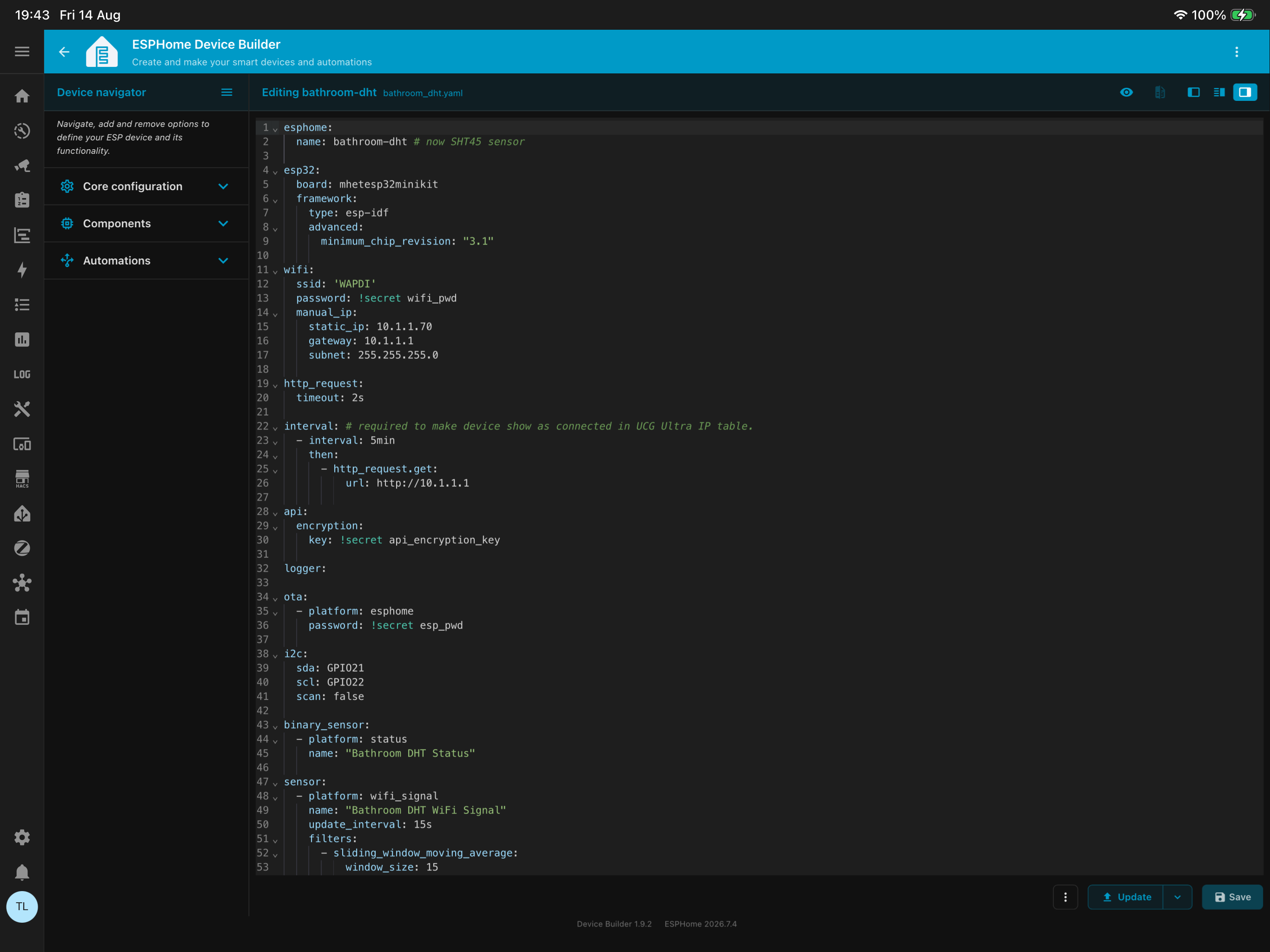

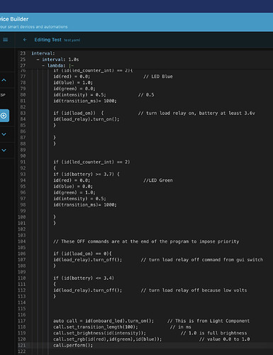

None of the screenshots you posted look like the ESPHome editor. It looks like this (no matter what HA theme you are using):
Are you sure you are not using VSCode or the Studio Code add-on/app?
Because that’s what the colours look like.
And if you are then you can turn off syntax highlighting.
I’m not knowingly using VSCode or the Studio Code add-on/app.

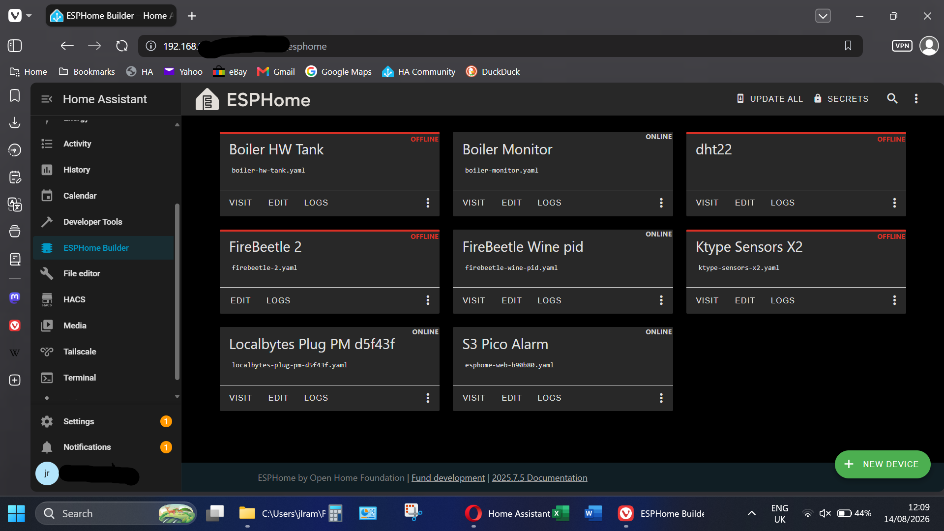

If I click on ESPHome Builder in HA, I see this:-
If I then click on the FireBeetle 2 EDIT ‘button’, I see this:-
(Although I have scrolled down a bit to the coloured text area).
Which is slightly different to your photo.

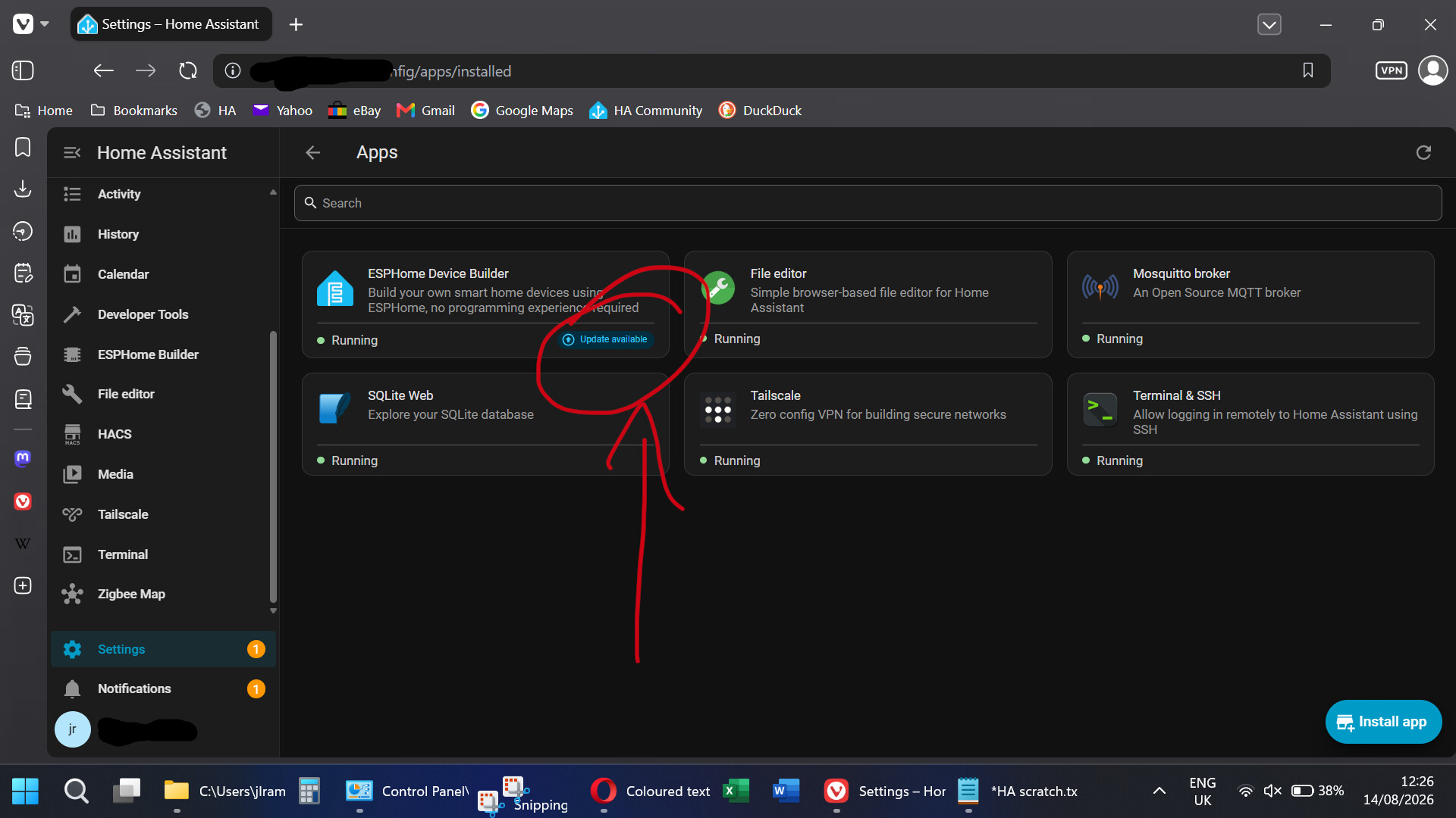

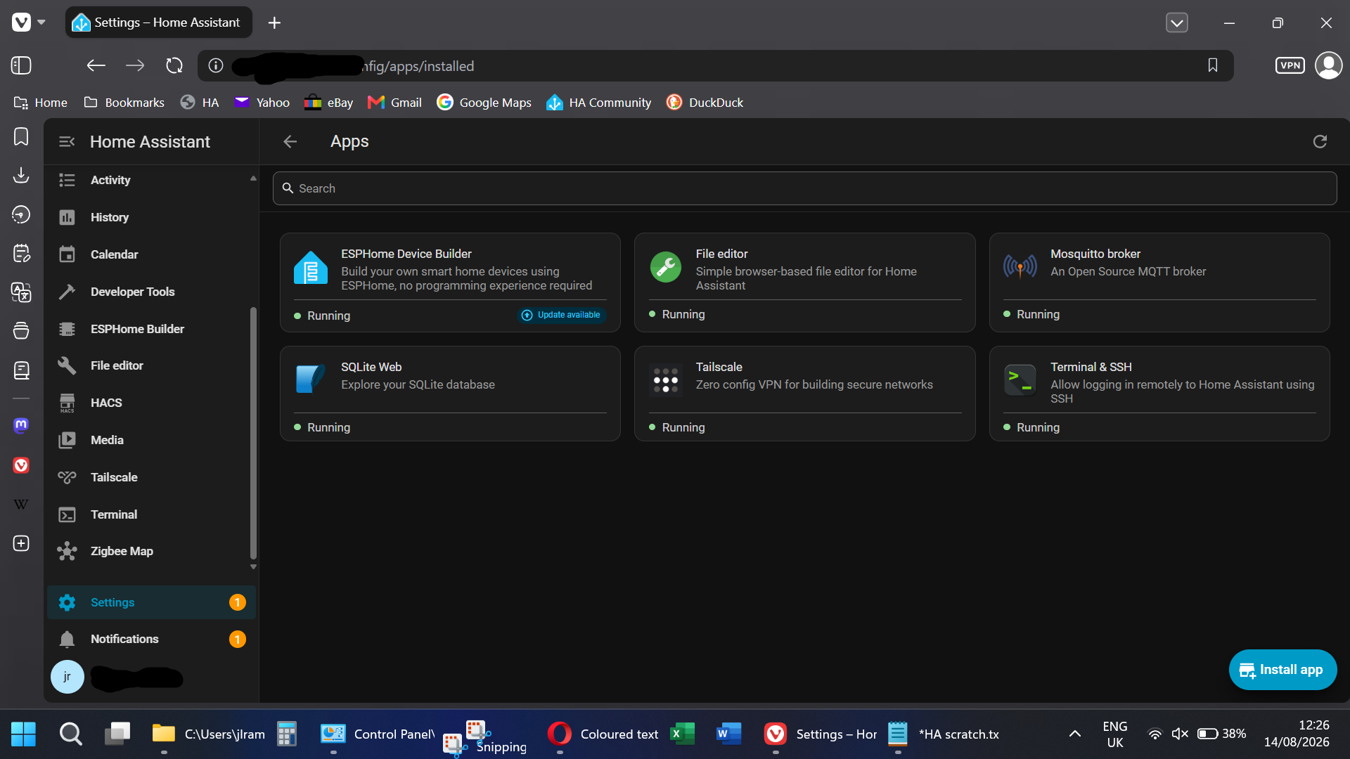

I’ve looked in Apps, in HA, which looks like this:-
I’ve looked in HACS, and can’t see either program as ‘downloaded’ or ‘waiting for updates’…

You are using an old version. Current version of the app is 2026.7.4. Click the update button.
Also FYI, HACS is for 3rd party integrations and dashboard resources. ESPHome is a core app and integration. It will never be in HACS.
Thanks.
Well spotted.
I didn’t consider the colours may be related to the builder version.
I stopped updating builder around 12 months ago, as one update screwed big time with a number of my projects and I decided to stick with 2025.7.5.
But thanks for your input and for the (likely?) solution, but I’ll not update at the moment. I’ll do it when I find I have to at some point, maybe… :face_with_peeking_eye:

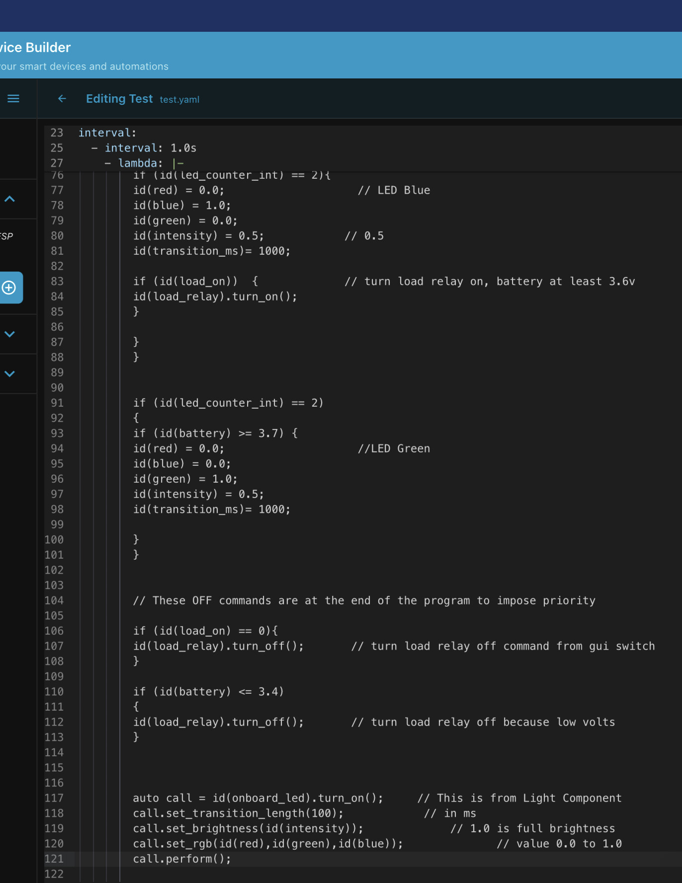

The longer you leave it the more breaking changes you may have to deal with. 12 months is already excessive. And there are no highlighting issues in the latest version. I pasted your code into a new project:
