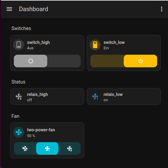

Finally I found out what needs to be done. Maybe this post helps others, or the future me.
I installed a fresh HomeAssistant and simulated the switches I have. This alone took some effort, as just creating switches did not really work out. I failed setting their state. So I created to drop down lists that manage their state. Then I connected two switches to control the drop down lists to show it in the dashboard like my current switches.
After that I created the fan template to also manage the drop down lists, and all of a sudden everything clicked into place. So here is my final result on a clean HomeAssistant, which means anyone should be able to reproduce the result.

I created a dashboard to visualize all these helpers:
