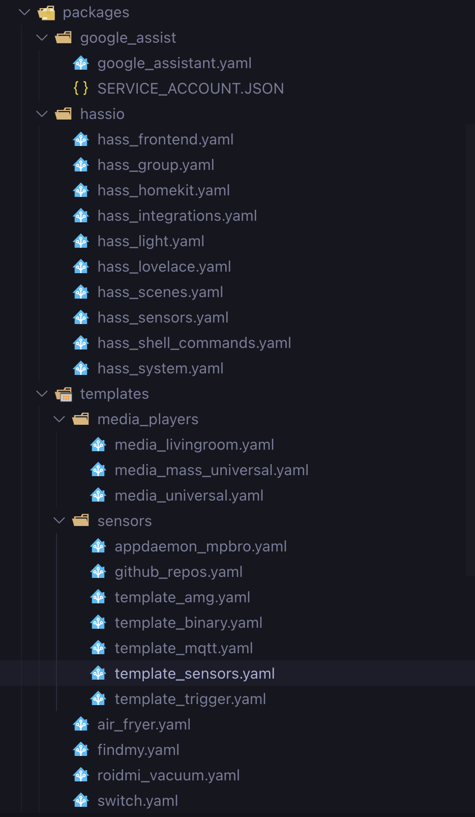

Use !include_dir_named packages, where you can have additional folders with individual files.
homeassistant:
  packages: !include_dir_named packages
Yes, that’s probably the way to go.
I’ve been using a bunch of !include lines when testing so that I can easily comment them out in configuration.yaml. Probably just as easy to move the YAML files out of the packages directly.
