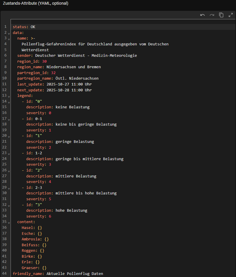

But the sensor is missing crucial information in the attributes content:
It looks like there is no data below data.content.%TypeOfPollen%
Was there a change to HomeAssistant that limits the depth of attribute fields?
