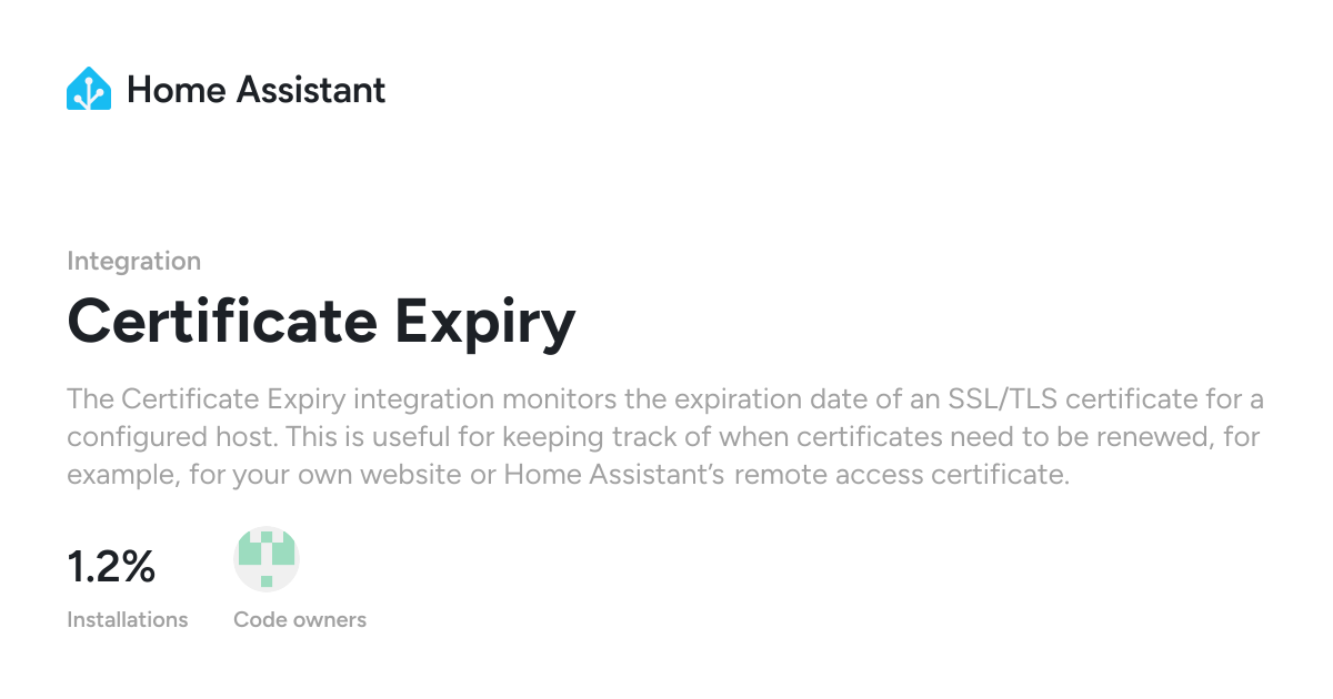

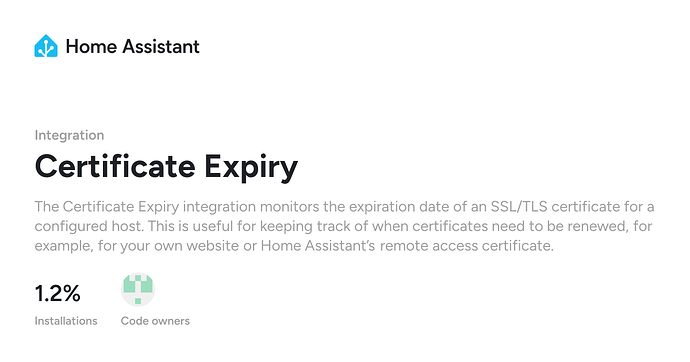

Can I ask why you do not use the cert_expire in HA?
No idea if it works on IMAP too though.

cert_expiry fails sadly on IMAPS…
