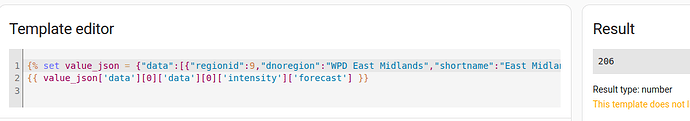

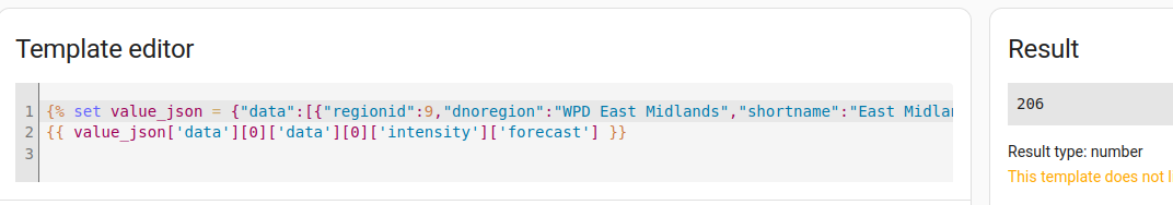

You can experiment in Developer Tools / Template. Here, I set the variable value_json to the response then test my template:
{% set value_json = {"data":[{"regionid":9,"dnoregion":"WPD East Midlands","shortname":"East Midlands","postcode":"LE16","data":[{"from":"2025-06-16T07:00Z","to":"2025-06-16T07:30Z","intensity":{"forecast":206,"index":"high"},"generationmix":[{"fuel":"biomass","perc":27.9},{"fuel":"coal","perc":0},{"fuel":"imports","perc":3.5},{"fuel":"gas","perc":43.8},{"fuel":"nuclear","perc":0.6},{"fuel":"other","perc":0},{"fuel":"hydro","perc":0},{"fuel":"solar","perc":13.4},{"fuel":"wind","perc":10.7}]}]}]} %}
{{ value_json['data'][0]['data'][0]['intensity']['forecast'] }}
