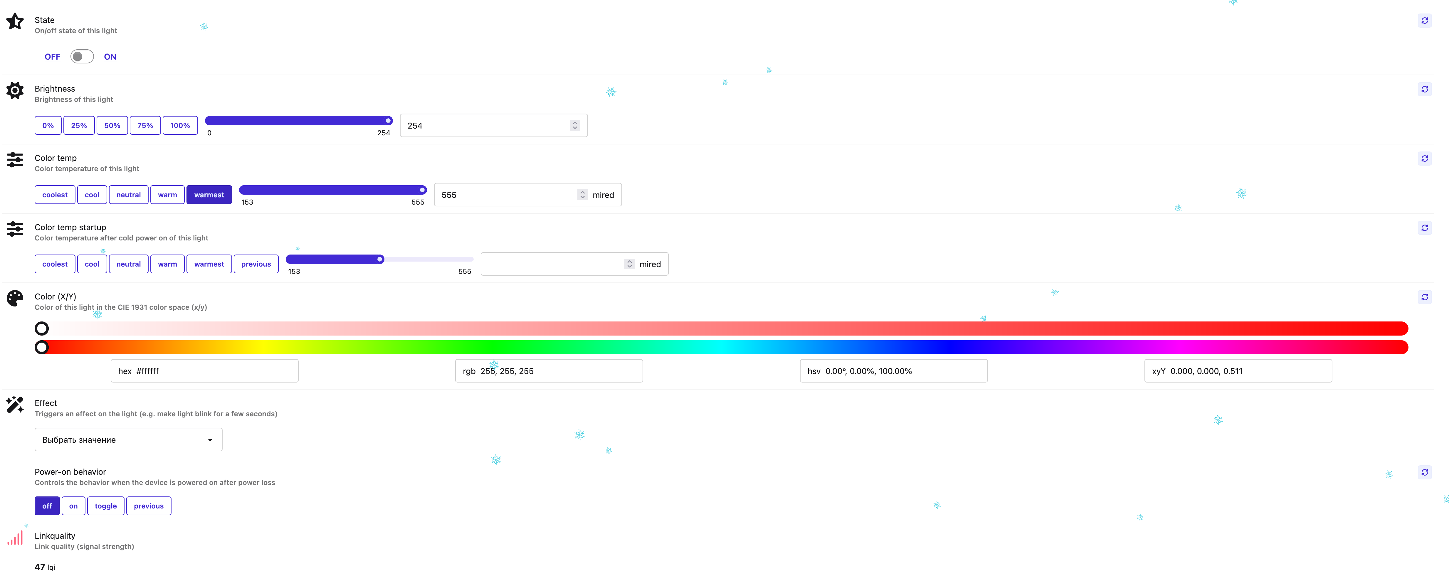

Bilresa, it appears, can do Zigbee within ZHA (ie. can fully integrate into a Zigbee network rather than just using touch link). Ish.
https://www.reddit.com/r/tradfri/comments/1plqavn/bilresa_on_zigbee/
I managed it with a full reset (hold pairing button in battery compartment till red lights go off). Four presses of button. Then 8 presses of button. LEDs on device then switch off. ZHA picked it up straight away.
What works/makes a zha_event:
  • Scroll wheel left/right registers
  • Top button registers
What doesn’t work/make a zha_event:
  • Bottom button does nothing (it also doesn’t register anything in Matter either; but here it also doesn’t change how the other buttons register)
  • Long presses/double presses/triple presses on the top button.
  • Pressing the top button is required to wake the device.
  • Moving the scroll wheel too fast for the device still results in it not registering all movements (eg. a rapid full turn will only result in it registering 1 or 2 events, this seems to be a problem in Matter also).
It seems to behave as if it’s giving instructions to a light directly, providing a number on the scroll wheel of 1 - 255 (under params/attributes). Button presses register as on/off events.
