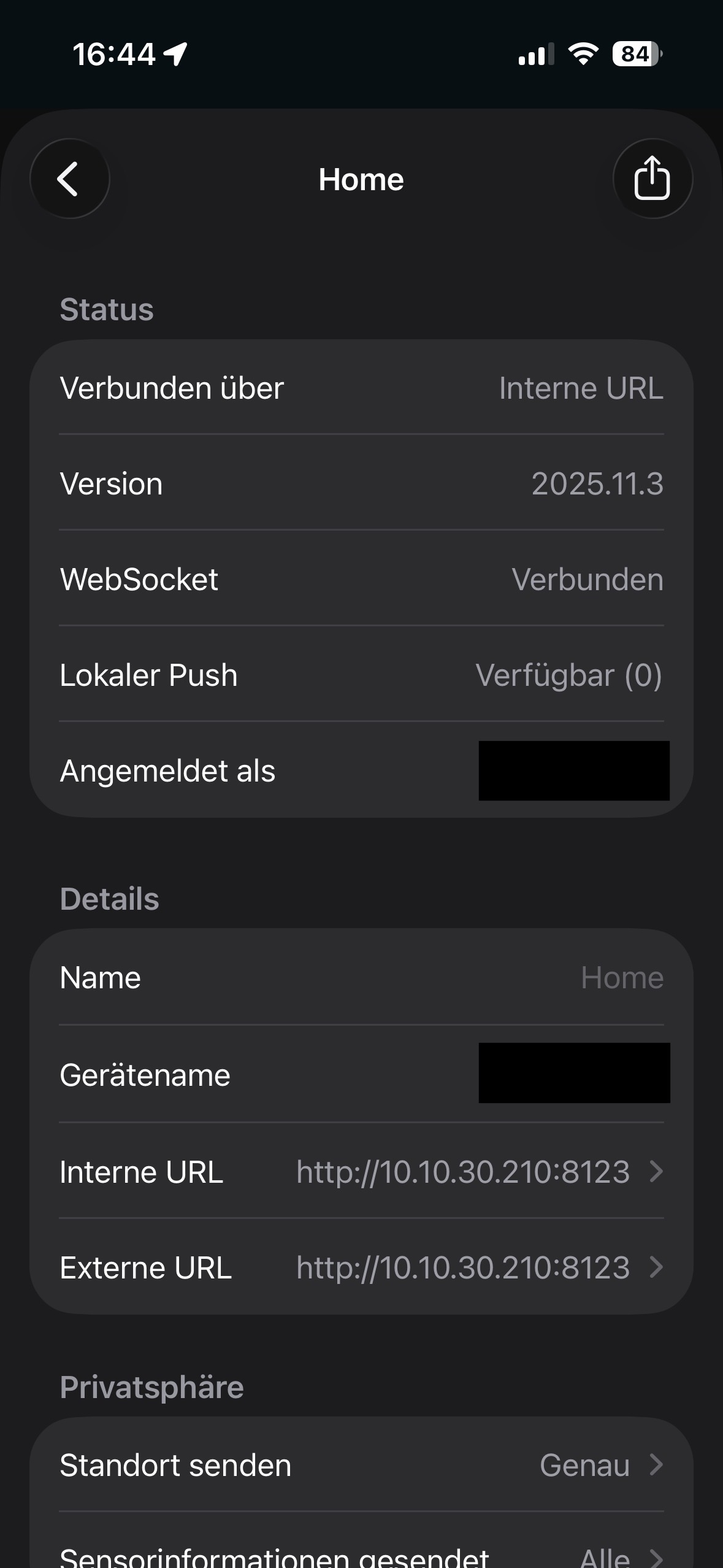

My Home Assistant installation is generally running perfectly. However, with the iOS app, I frequently get the message “Connection lost. Reconnecting…”
If I then completely close the app and reopen it, access is restored immediately. So I can’t detect any persistent connection problems.
The message only appears if the app has been running in the background for a while. When access is working, I can always swipe the app away and open it again without any problems after 1-5 minutes with a working connection. The message only appears after some time.
I’m accessing exclusively via the local IP address. There’s definitely no address conflict. Home Assistant and the clients are on the same subnet/VLAN.

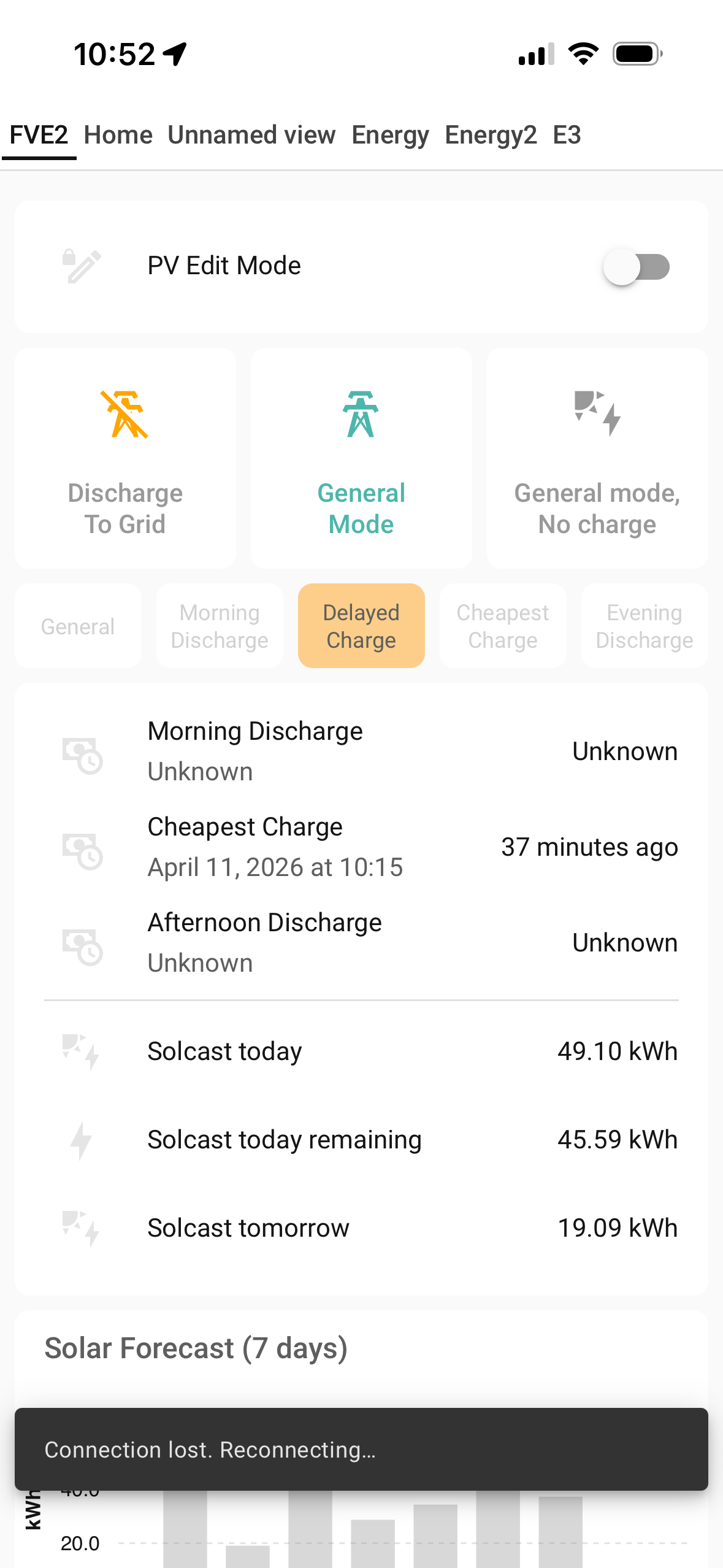

I can trigger the issue on demand by enabling/disabling an ‘Advanced Camera Card’ which appears/disappears via a condition.
When the card is enabled it works fine, and continues to. If I disable it and re-enable it the app loses connection until I restart the app.

I can confirm this issue. The app just goes “connection lost. Reconnecting.,” at least 10 times a day😭.
And pull to refresh doesn’t fix the issue but killing the app and relaunch does.
