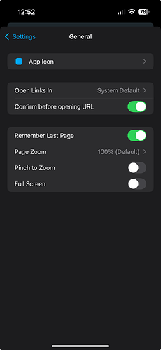

In your the companion app settings what do you see here?
The Android version doesn’t look like that. I’m also not seeing the top 2 options from the image you posted. I’m not seeing anything about opening links.
Sorry didn’t realize that option isn’t available in the Android app. I do not show those options either…
