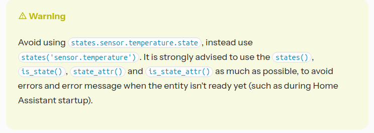

Basically, you’ve included 3 failure points…
  1. Using the state object method instead of the, recommended, states() function. The following warning has been in the docs for over 5 years:
  1. Not providing defaults for the float filter.
  2. Not providing an availability.
Some situations do not require both defaults and availability, but most situations will require at least one of them to be used to get reliable results.
While it’s not a technical error, you are also not using a binary sensor for binary output.
