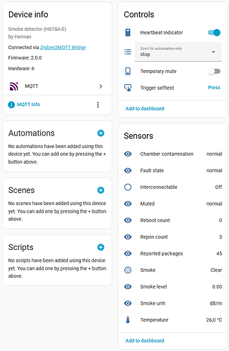

This is what new Heiman HS1SA-E provides to Home Assistant by using Zigbee2MQTT.
While the standard HS1SA is a solid detector, the HS1SA-E provides significantly more information. It’s a Zigbee 3.0 device that offers better stability and more exposed entities in Home Assistant. For a power user, seeing things like specific fault statuses or sensitivity parameters (depending on the quirk) gives you peace of mind that the device is actually alive and thinking, not just waiting to die.

well…thanks for the feedback, very nice … zigbee2mqtt doesn’t provide a lot of parameters for my device :frowning:
That’s my output in zigbee2mqtt → qqq hosted at ImgBB — ImgBB

Nope. Awaiting for bug fix in the next version of Z2M
that diagnostics entities? it will be fixed with next release.
thank for this post will buy that :slight_smile:
I would say it's diagnostics entities, yes.
got it, please try with next release.
