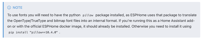

Have you seen this note in the documentation?
Yes, I have installed the pillow package already, but to no avail, alas.
