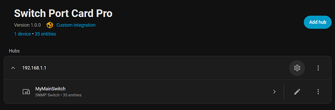

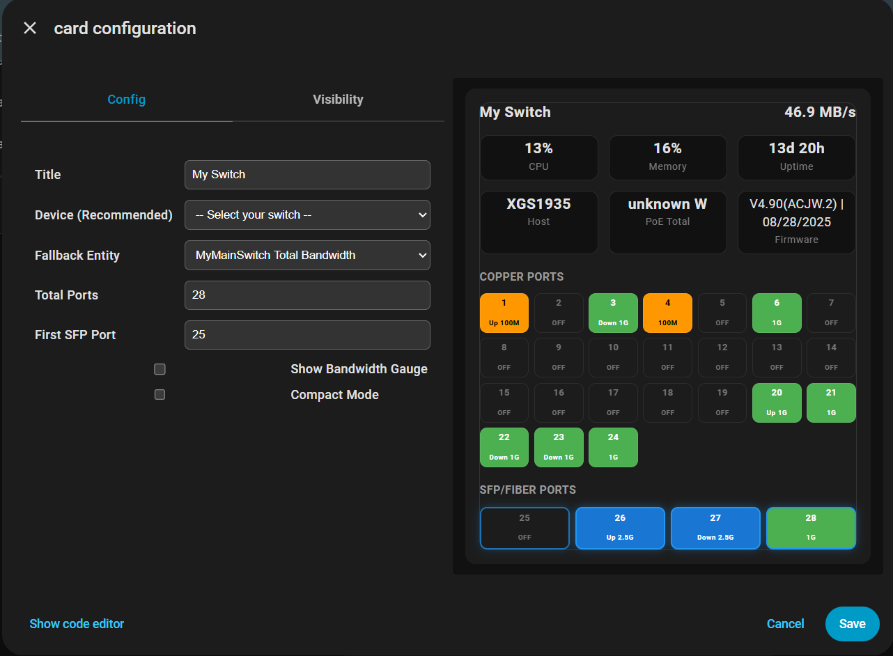

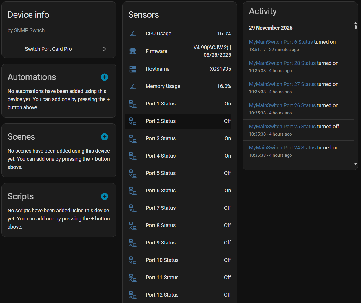

The integration is available on HACS since today! Features have been greatly extended:
  • Supports multiple hubs (switch instances). You can monitor your whole switch farm from one dashboard
  • Fully configurable UI to show the information per port as you want it.
  • Automatic detection of number of available ports (if standard oid is honored by network Switch)
  • Visible vlan tagging (ports show to which VLAN they belong)
  • Indication of port name, vlan id, Rx speed, Tx speed, POE power, POE status, custom fields.
  • Bandwidth per port, bandwidth throughput in total tracking. Cpu load and memory load indication as well as firmware version and total POE budget use.
  • Custom system OID possibility (monitor your specific need like temperature)
  • Custom per port OID (will be ‘walked’ and information collected per port)
  • Compact mode (for smaller dashboards)
  • Hover Tooltip per port showing status details per port
  • Integration (and card) configuration screen
  • To be released this week: Port coloring mode (heatmap, link speed, actual speed, vlan)
  • Dark / Light Mode

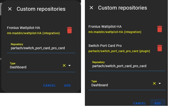

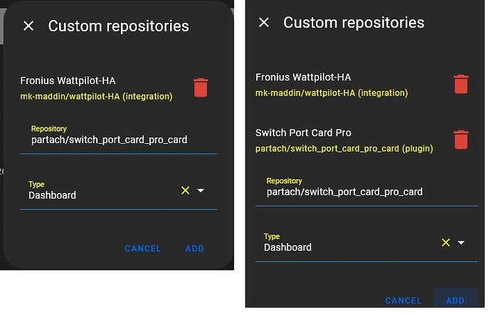

I’ve removed the integration, restarted HA, downloaded switch_port_card_pro (edited), restarted HA, confirmed the integration was OK (V0.8.2 with 32 entities). Then HACS, custom repositories (partach/switch_port_card_pro_card, dashboard) & clicked ADD. It appeared to add (and the pycache folder was loaded into the \custom_components\switch_port_card_pro folder).
However, there is still no resource listed. Can I manually add the resource?

Clicking on the link https://my.home-assistant.io/redirect/hacs_repository/?owner=partach&repository=switch_port_card_pro_card takes me to the redirect page and clicking on Open Link gives me Repository partach/switch_port_card_pro_card not found
If I try, as each time previously, to manually add the card as a custom repository, it looks like it adds - but clearly does not.
I notice the card says “(plugin)”. Is this the issue? I’m running HA in a docker container. My (very) limited understanding was that plugins were very difficult to run in a Docker environment.
BTW, on restarting HA, the partach/switch_port_card_pro_card repo is no longer listed as in the 2nd image above.
Plugin is the type of the hacs resource. Dashboard is indeed the good setting. I see both used in different circumstance. Terminolgy confusion also for me…
I dont have much understanding regarding docker installations.
So either:
  • Custom repository route (which should be the easier route), which should add the resource automatically. If this does not work:
  • Manual install. Forget hacs. install the card as shown above in /www/community/… Then add the resource as also shown above in Dashboard menu.
