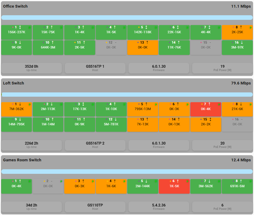

IF all 3 switches are powered on, you can see all 3 at once in the dasbhoard. Would love to see a screen shot of that :blush:

Yes, but these switches do not report PoE power usage per port so that didn’t work. Using snmpwalk I found the single aggregate power figure for all PoE ports combined, hence the custom field.

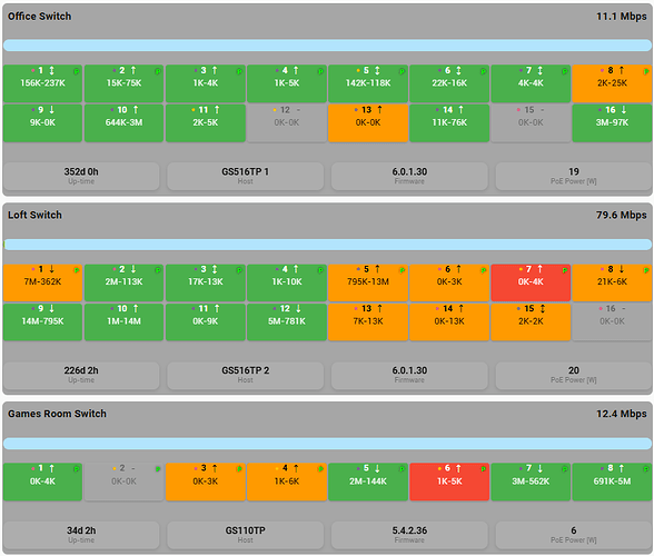

I have four switches in continuous use, but here’s a combined screenshot of three of them together:
Awesome! Well, that is why I introduced the customer field(s). Nice it all works, made my day

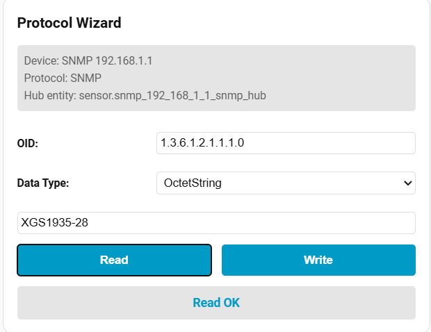

I have created GitHub - partach/protocol_wizard: The Protocol Wizard helps you build your home assistant devices without need for any yaml!
Pretty proud if it…
It supports SNMP exploration and creation of and entity you want run time. (no YAML required).
It also support Modbus as protocol in the same way.
My goal: the protocol wizard to support any popular protocol where you can create entities at will run-time, plus explore the devices to find what you need.
