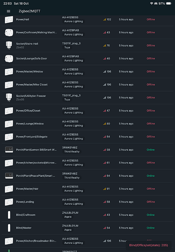

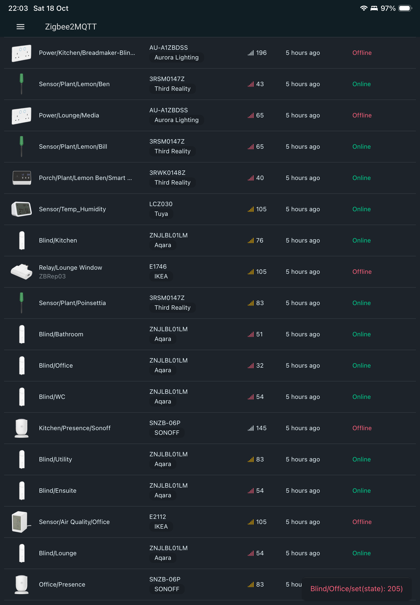

At 16:58 today all devices stopped working.
A full pc reboot has not resolved the issue.
Any ideas anyone?
It ran for nearly 24 hours before this collapse.

Can you show us the Zigbee network map from the Z2M front-end?
Unfortunately the map never builds it just spins forever since the crash
Everything has been offline/ unresponsive since 16:58.

All devices are offline, none are communicating
Every single device is unresponsive

I have tried it with 35 router devices all with a great signal and it still dies .
