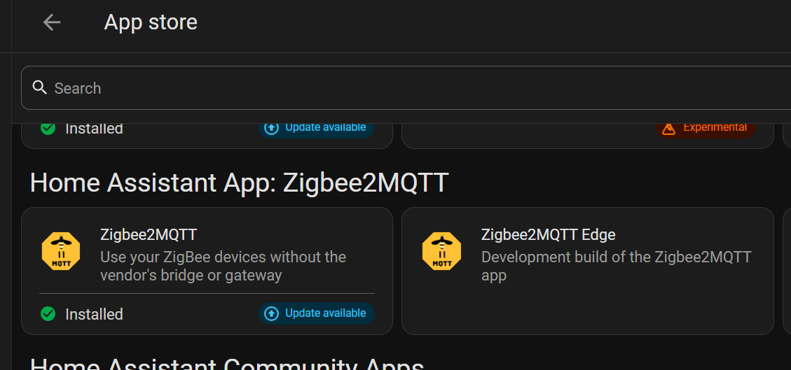

Go to Home Assistant > Settings > Apps > Install App and scroll down to the Zigbee2MQTT section. You should see an option to download the Edge version from there.

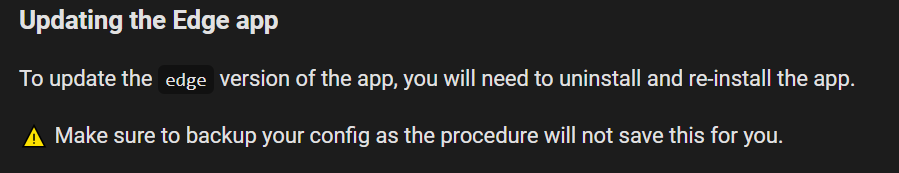

Do note the following warning, though. Might be safer to use the Edge version for your outbuilding & keep the mainstream Z2M version for your house for updates.
