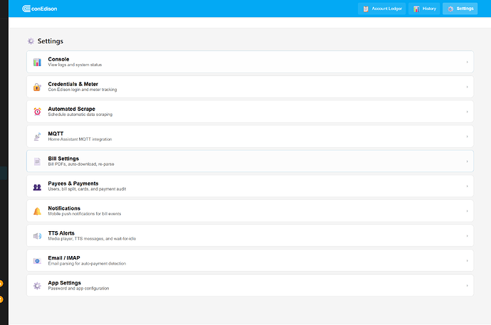

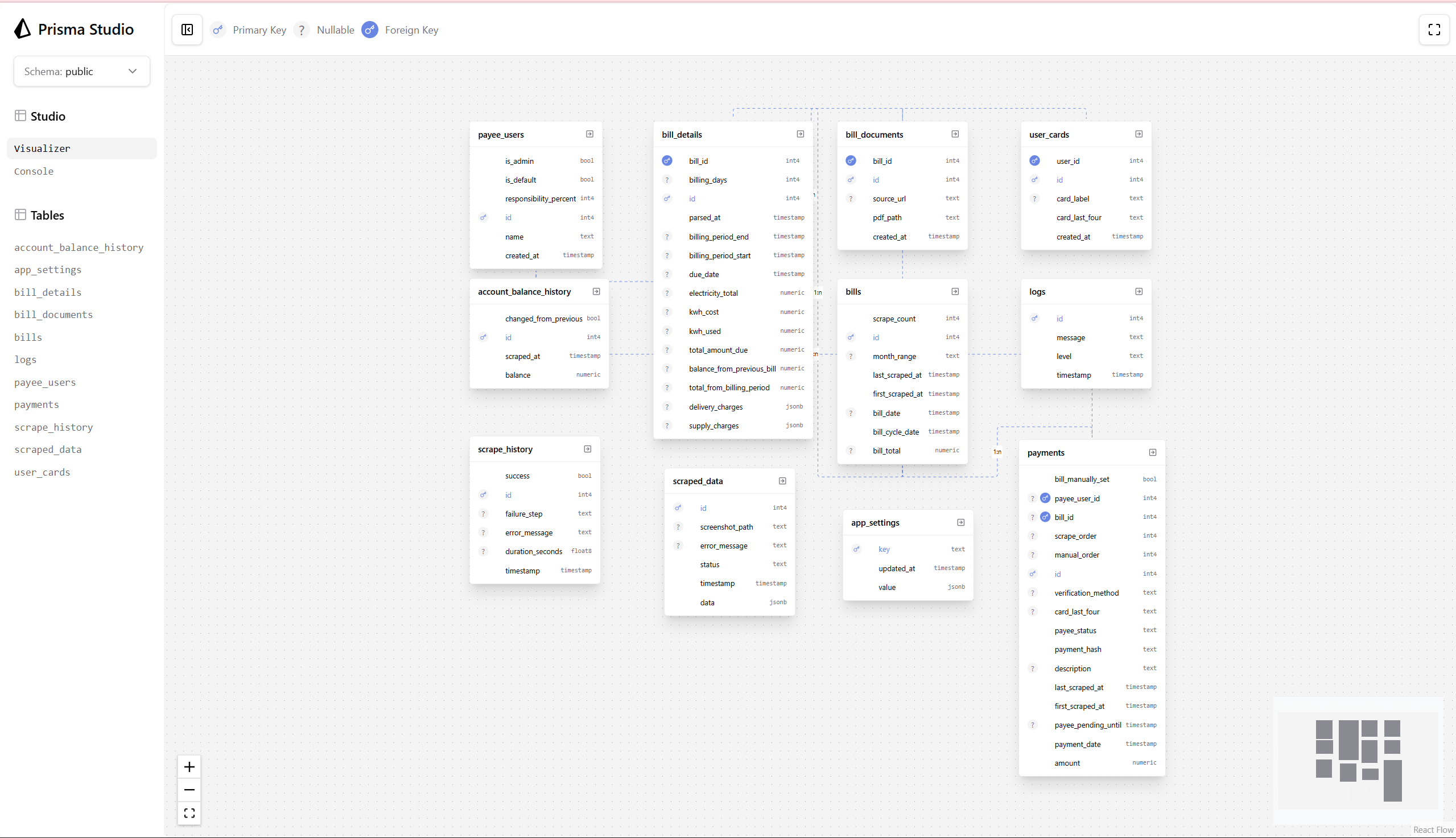

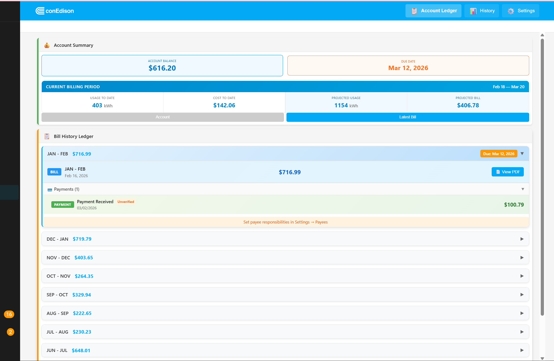

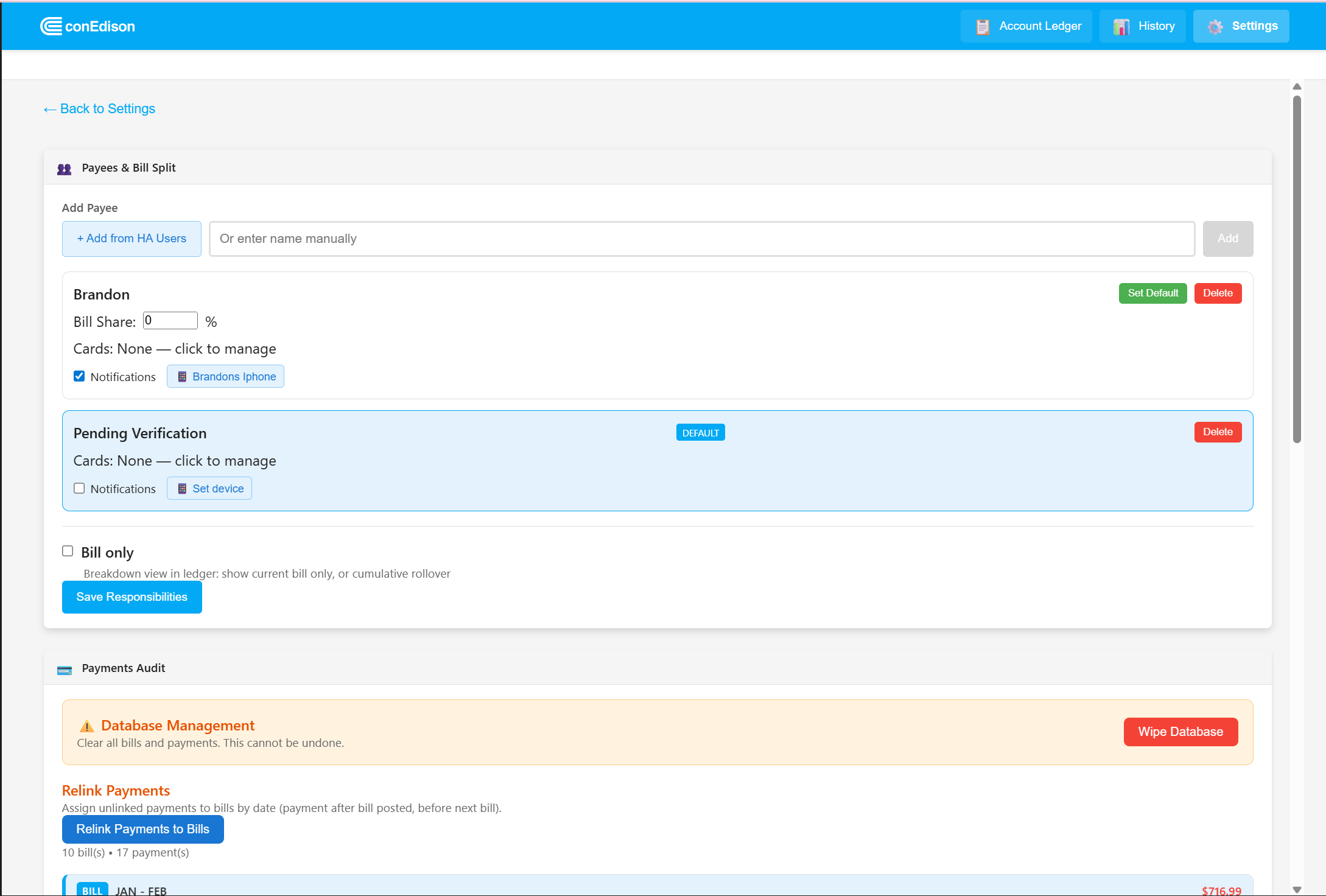

Inspiration was to get away from opower integration ended up simply using same api they use (for now) but added another layer of scraping via con ed website which pulls payment history ect, made for those who share utility with a roomate with payees and splits ect and can assigbed scraped payments to payees via imap (W.I.P) essentially i originally had this working with sqlite3 database but switched to postgres with prisma studio (accessible in ha lol) for dev purposes. so allot of things have to be rebuilt but this is super dope

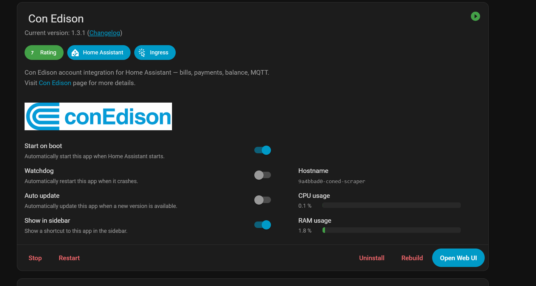

sorry for delay, you can grab it at Con Edison: Addon + Integration
nice. Got it set up and running. although I did have to restart it after initial installation as it threw

I really want to give this a shot but I've had no success with installing the app after adding the repo. It just keeps looping over and over regardless of what device I try to install it from
Post the logs from the install
Stepped away for a couple of hours and came back to it installed!

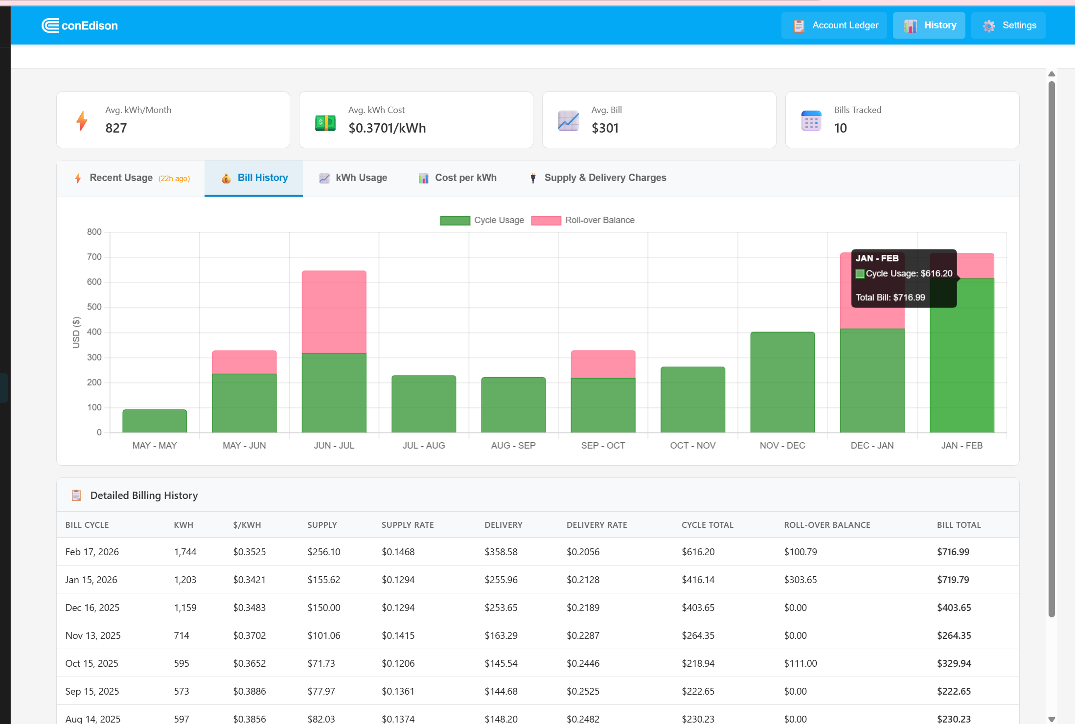

Hooked up my account and I'm so happy you made this. I can see so much more information compared to Opower! Hoping you keep developing this, it's amazing!

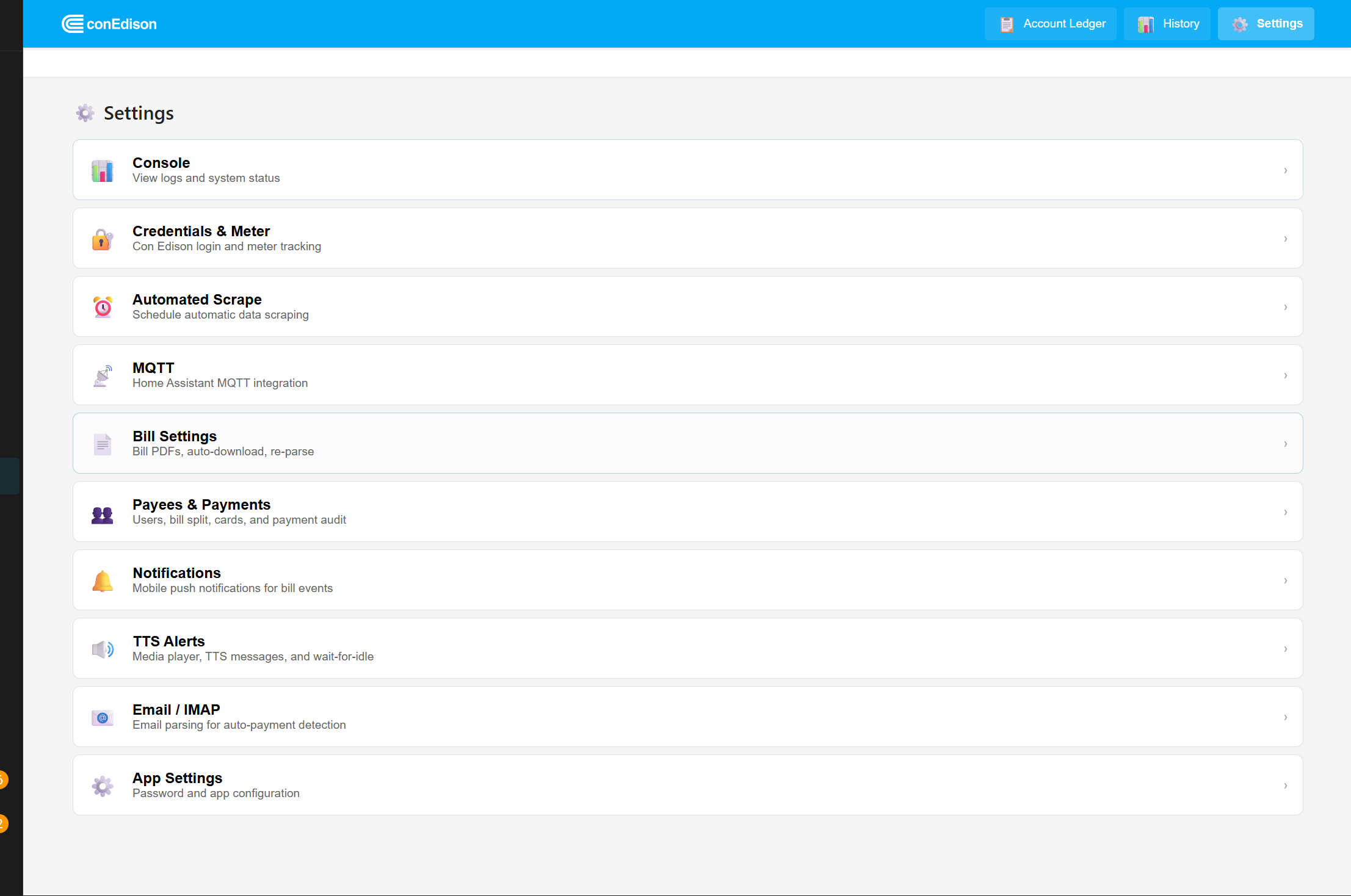

I however cannot find the MQTT sensors it supposedly created. I couldn't find any fields to input my MQTT broker creds either in settings. I feel like I'm missing something
More of a nice to have but I would love to have the history tab as the homepage instead of the Account Ledger, any chance we can get that option? Dark mode would be pretty neat too!

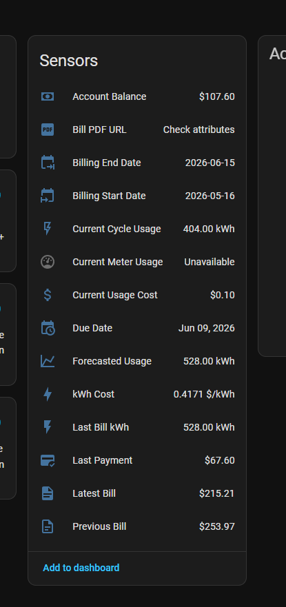

From devices page search for ConEd Connect:
ConEd Connect is the integration side of the this app (addon) thats auto installed, mqtt is no longer used all data is sent to ha via ConEd Connect :slight_smile:
Awesome! Got the entities. You may want to update the documentation in GitHub.
