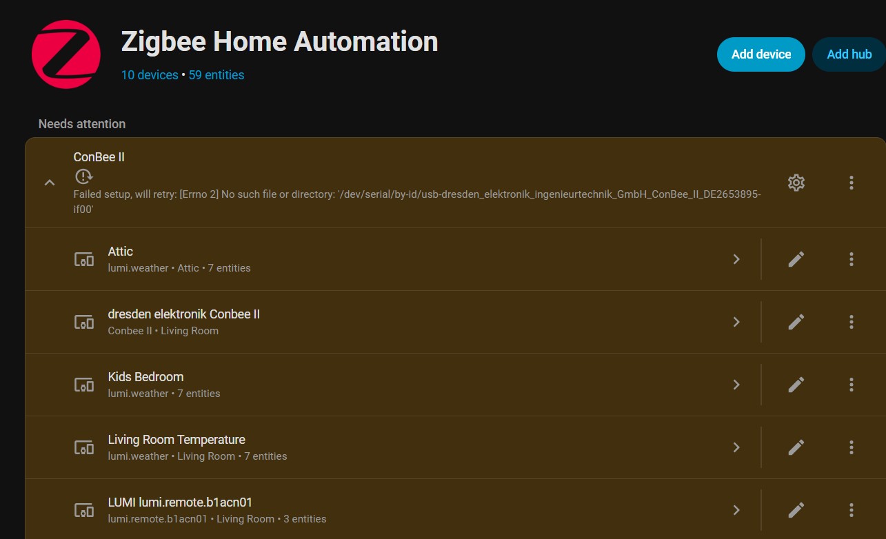

Hey everybody, my Zigbee devices are no longer working after update. I’m running on a pi 4 from an image. I saw a similar thread but mine seems to be on by-id.
If you have a suggestion please give me step by step. I’ve had HA for 10+ years but am definitely an amateur.

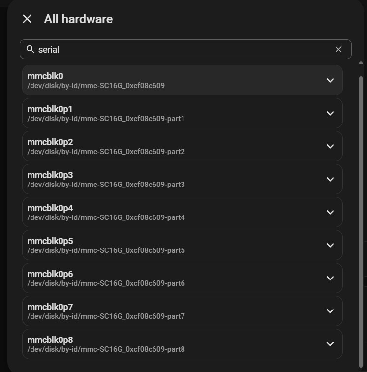

I had a problem with a Conbee III that did that after an extended power cut (replaced my electrical panel). The device name changed when it came back up. I fixed mine by going into Integrations > Zigbee and migrated my network to what it was changed to. Confirm you can see your controller in Settings > Hardware > All Hardware before you do.
My pi is connected by ethernet cable if that’s what you mean.
There’s a lot of hardware listed and much more in each group. I’m not sure where to start looking.
Here’s mine - you can see my ZWA-2 and below my Conbee III.
