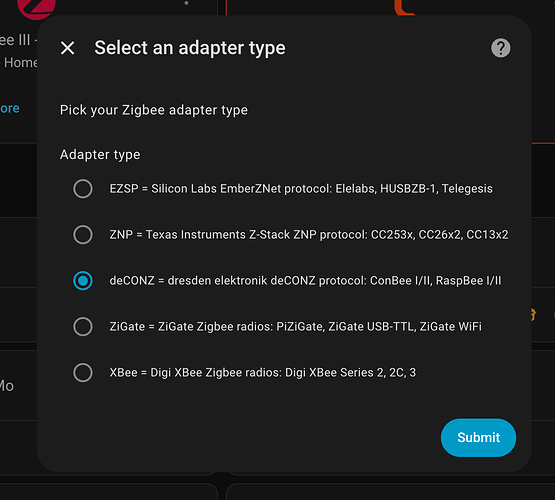

  • In the ZHA setup page, make sure you choose deconz as the radio type, then paste in the serial path on the next screen. This will ensure that your device is always found if you unplug it or restart your VM.

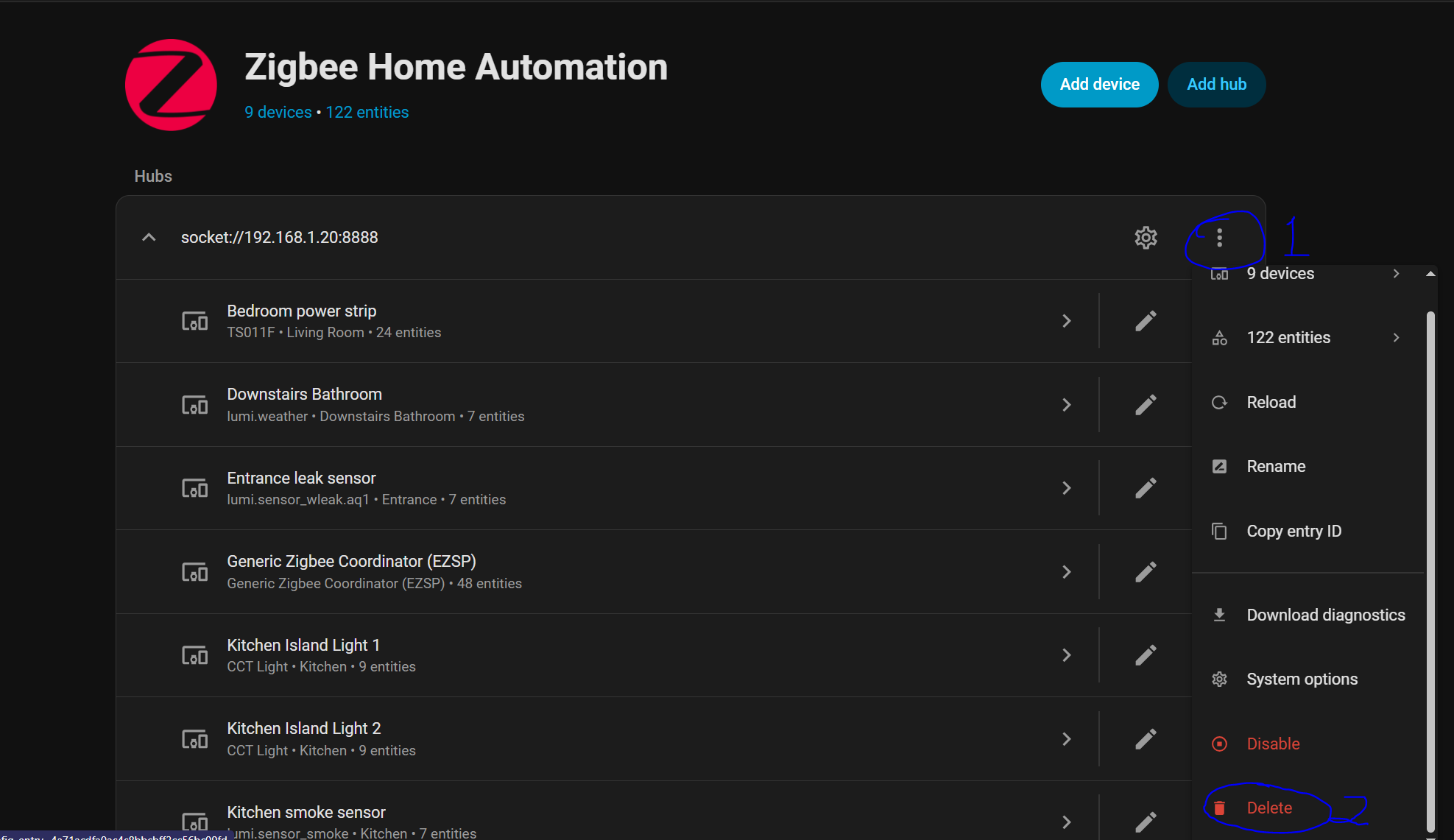

When I look at ignored and disabled…Oh good lord…it is in Ignored! I had no idea it was there—that must be what’s blocking the Conbee? That also explains, I think, why Zigbee discovery (of devices) looks like it’s working. How exactly do I remove it? Do I “stop ignoring” it and then delete it? Thanks sooooooo much for your help!
I’ve never had to do this, so the below is purely a guess:
  • Pull out your conbee from the use port
  • Hit “Stop Ignoring” on ZHA
  • Click the ZHA integration > 3 dots > Delete
  • Restart HA one more time (just in case) and plug in your Conbee coordinator.
  • If ZHA doesn’t pop up due to autodiscovery, add it manually using Add Integrations. Make sure you choose deconz & paste the /dev/serial/by-id/ path for your Conbee.
Note that the above will cause your entire zigbee network to be wiped away, so you will have to re-pair all your devices.
Okay, this is very strange…I stopped ignoring it and it disappeared! It’s not appearing in integrations, and now I don’t know where it’s gone…

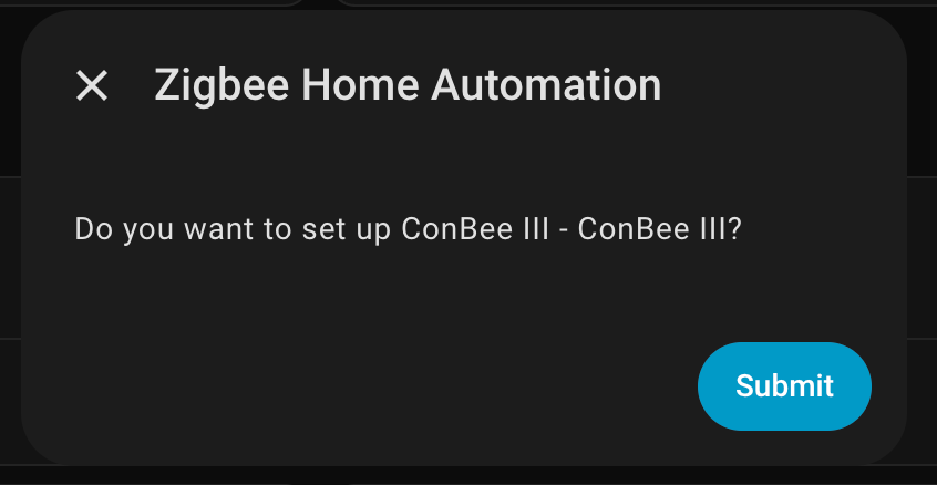

All right, the first screenshots are when are try to use autodiscovery…

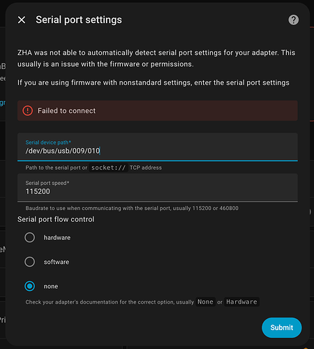

Next, when I try to add manually but using the detected serial path, then when I input it manually:

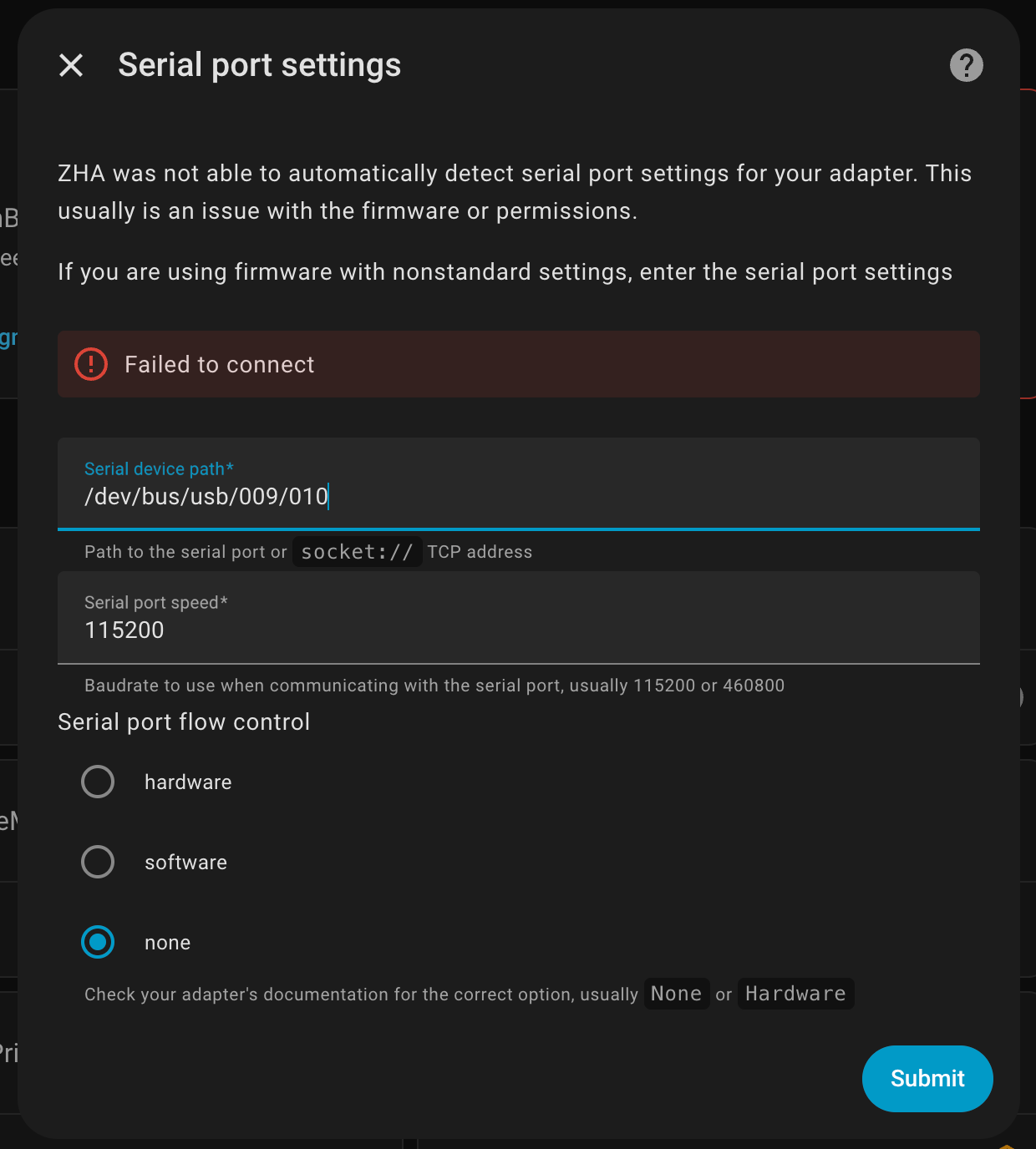

And now if I try to use the USB path:

I’m honestly stumped. Only thing I can say is that the last screenshot doesn’t look right.
Should be/dev/ttyUSB0 according to your earlier screenshots.
If that still errors out, it HAS to be a permission or firmware error, like the error says.
