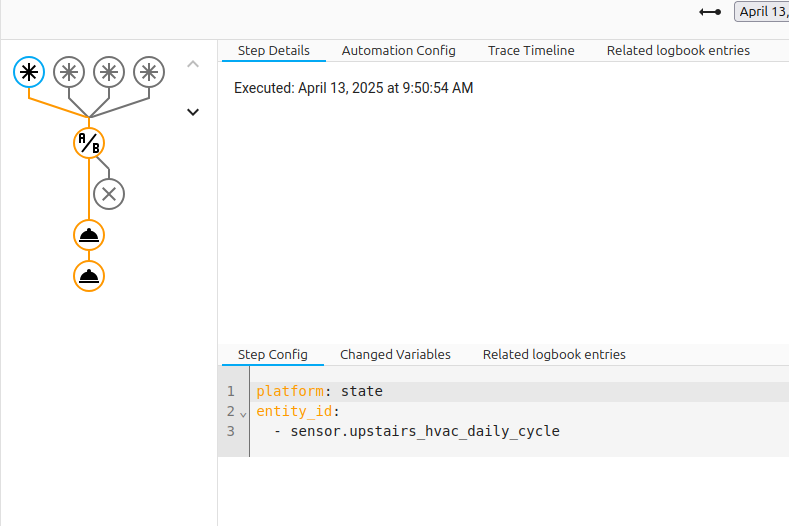

Ok - so I thought I had this, but it seems I still don’t in at least one of these cases.
EDIT: And I found it already. Solved again.
Seems I forgot about the triggers “id” assignment used in the condition. For anyone else who finds this, hope that tip helps.
This should be identical to my original one, but for a different specific HVAC zone. Its resetting the manual temperature adjustments when daily_cycle changes, while vacation is “on”. It should be ignoring daily_cycle because vacation is on.

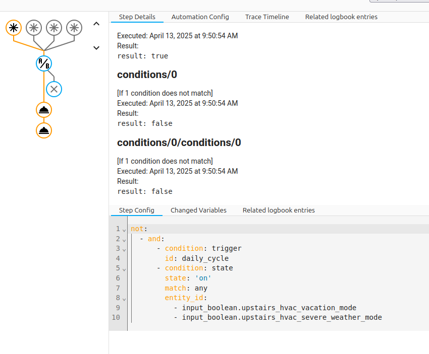

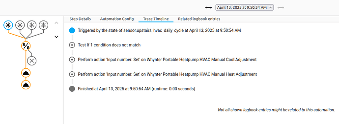

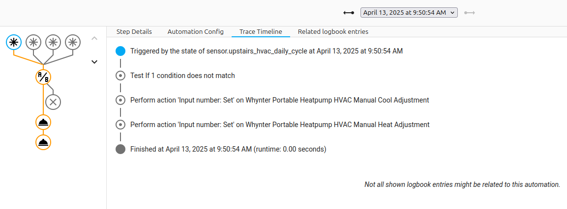

Due to this being “on”, I think the condition should have stopped the automation running.
Trace information:

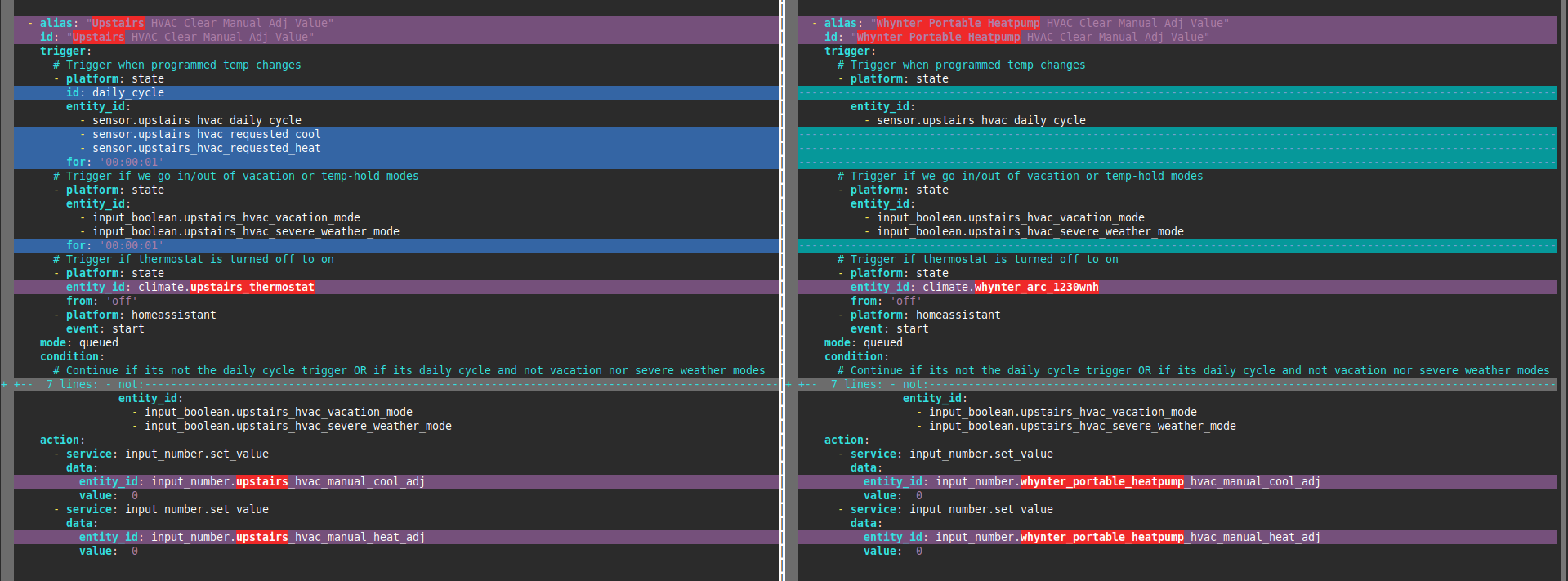

And comparing to a different one which is working properly, even vim-diff shows no deltas in the condition section…so why does one condition run and the other not?
Maybe someone here can spot my mistake?
