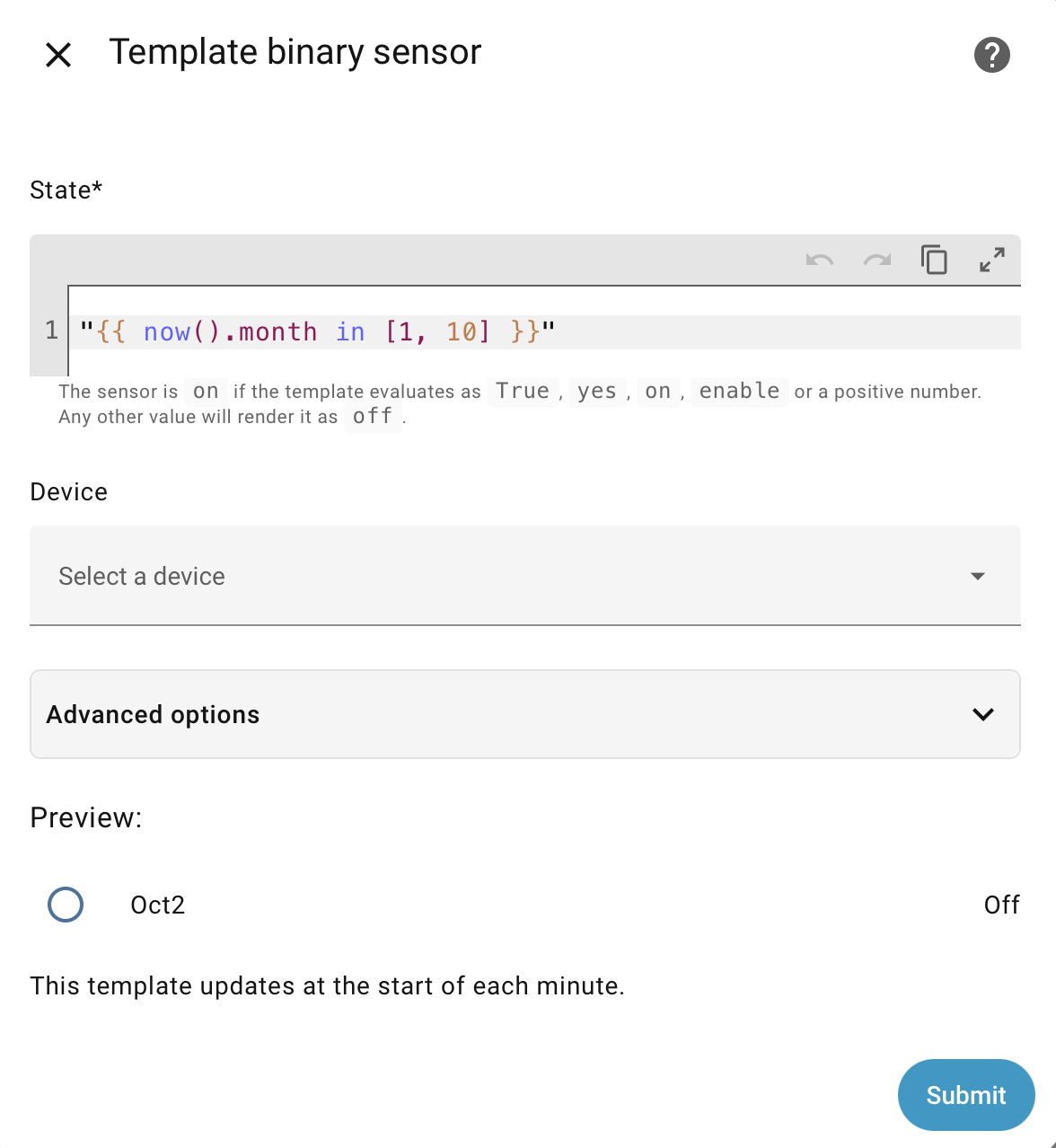

The status always shows “Off” on the Template binary sensor page below, whether or not I change the months to be “[1, 10]” or “[1, 11]”, but if I run `“{{ now().month in [1, 10] }}” ’ through the Template checker it returns True when [1, 10] is used.
Get rid of the quotation marks in the state template selector, they don’t belong there.
Fab-u-lous - thank you so much!!!
Works perfectly!
