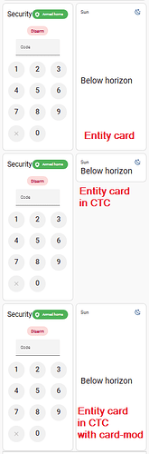

Next, about a card’s height (which you may not have noticed yet).
The config-template-card does not work nice in Horizontal stack card & Grid card (the latter is used inside sections).
Will be fixed as soon as this PR is merged (there are some things to be done before a next release is created).
Meanwhile, this can be fixed by card-mod.
Play with this:
type: grid
columns: 2
cards:
  - type: alarm-panel
    states:
      - arm_home
      - arm_away
    entity: alarm_control_panel.security
  - type: entity
    entity: sun.sun
  - type: alarm-panel
    states:
      - arm_home
      - arm_away
  - type: custom:config-template-card
    card:
      type: entity
      entity: sun.sun
  - type: alarm-panel
    states:
      - arm_home
      - arm_away
    card:
      type: entity
      entity: sun.sun
    card_mod:
      style: |
        #card {height: 100%}
He should set height in apex-chart-card, and btw, panel-view, for full width graph
Height may be customized in apex-charts, of course.
But ANY cards in sections should follow a defined layout - i.e. occupy a provided height (defined by grid options).
When a card is placed into CTC - this breaks.
So => a solution was provided.

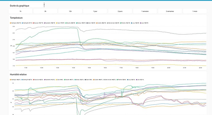

Hi
Thank you all of you for your help. I’m beginner with HA. I started few weeks ago.
I don’t use a Single View Panel because I would like to display multiple charts on the same page. So I thought sections would be the good way.
It works with this config. I had to set the width in config-template-card with section_mode and column 48.
The height is set in apex_config of apexcharts-card.

I meant, I’ve several charts on the same page (temperature, relative humidity, absolute humidity, etc.). Each chats have ~13 series.
This is why I use a section with grid, I don’t know if there are other ways. I’m a beginner.

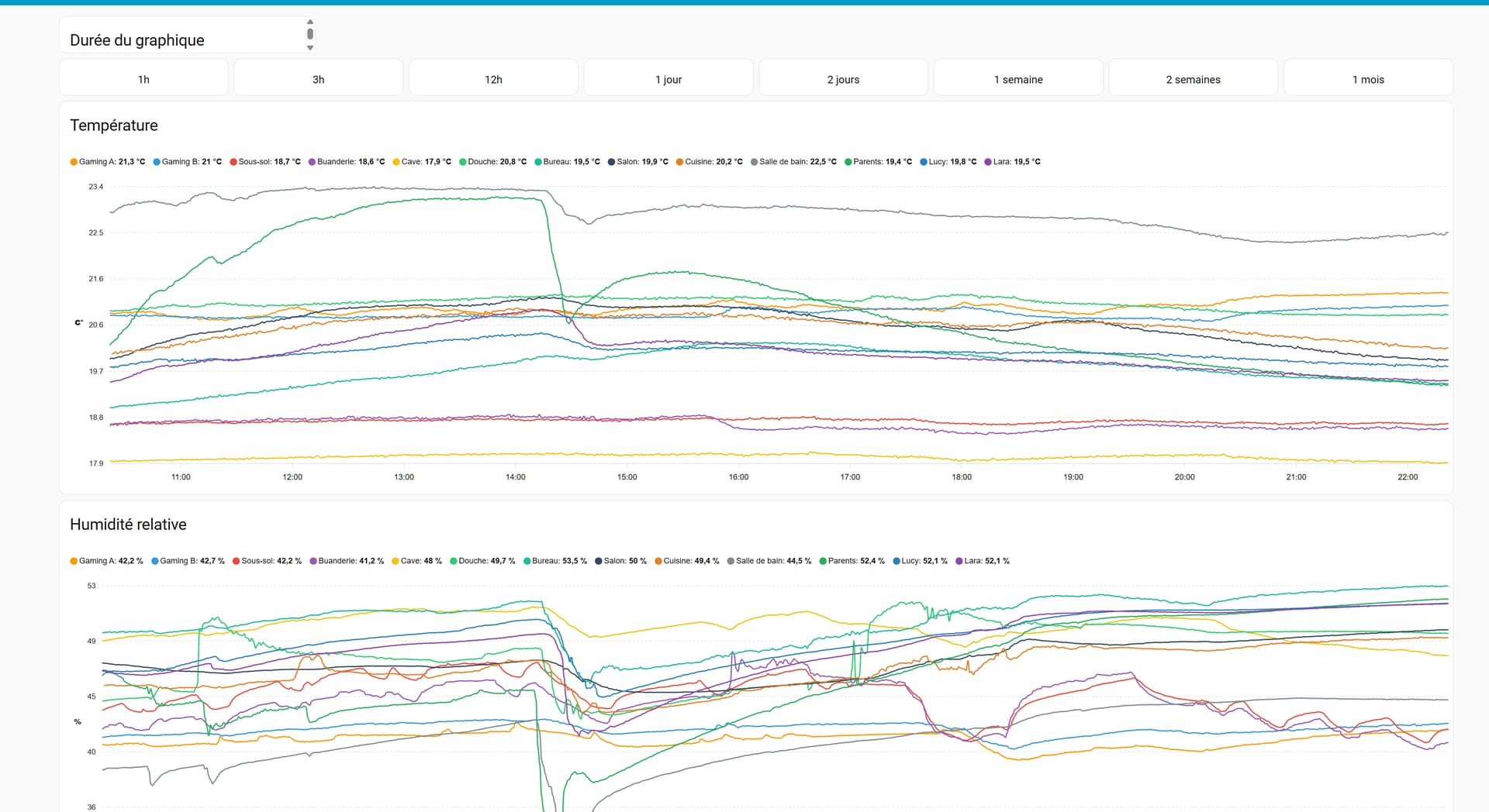

Thank you all of you for your help!
It works as I wanted.
I can select dynamically the duration with config-template-card (use 1.3.7-beta.1 instead of 1.3.6, we can define global variables or functions for the dashboard) and I display the charts with apexcharts-card
At the top of the dashboard I defined the duration and the aggreation (minute, hourly, daily, etc.) for the charts, thanks to :config-template-card
