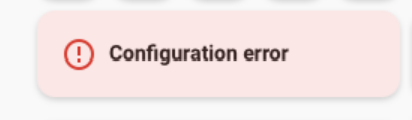

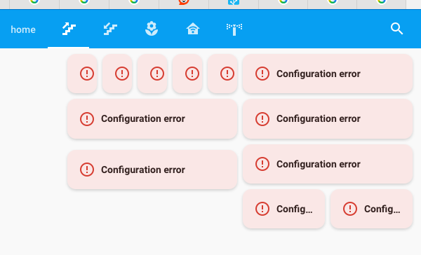

"Configuration Error" on mobile HA apps and all browsers (but not Mac app)
I have spent the past six hours trying to solve this problem and I just cannot. We bought this house a year and a half ago and it came with fairly extensive automation, managed by HA. I rolled back to a previous backup and have fixed a number of things in the setup. What I can’t get past is with every browser on every device (iPhone, iPad, Macs) I get “Configuration Error” as in the image I have added. I get the same error with the iOS app on the iPhone and iPad. The only place everything looks fine is the Mac app. I have not included the configuration.yaml - if it is relevant let me know. It has 35 lines in total and refers to once device.
I dislike not being able to solve my own problems and I truly appreciate any help offered.

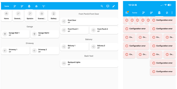

I have cleared the caches everywhere. Restarted devices, deleted and reinstalled iOS apps. Different browsers, different OS (Mac, Windows).
The image shows the same views on the Mac and iPhone.
![wertyjtrs|690x348](upload://cD9e8h1vUtrwStnQyyh7rA6ftLs.png)

Thank you Nick. Connecting via IP returns the same errors.
I switched to masonry view yesterday because one of the views (downstairs) kept returning something like “can only display one card” or something to that effect and I could not get rid of it in the panel view.
Otherwise all the views return the same error (except in the Mac app where everything is fine).
