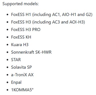

I’m curious how I can check whether I actually have the correct inverter version that supports Modbus TCP. It seems that only the later models support this — the ones with the small antenna at the bottom and the correct firmware.
The only information I can currently see is in my Fox dashboard, where the details of my inverter are shown.
H3-10.0-Smart
Supported models are:
So this isn’t working. I thought you meant something else, but I installed this and still have no connection.
You need to install the v1.14 beta or newer for the H3 Smart inverter being supported.
Since you have installed the stable v1.13 version, support for the Smart series of H3 inverters is missing.
