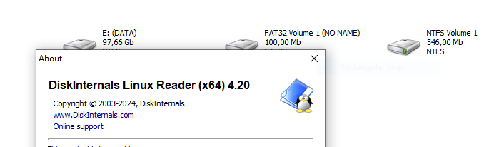

There's always the Diskinternals Linux Reader for Windows. That's quick to install and you can use all the Windows tools you're used to.
@ShadowFist That's great ... I've found something.

aint the easiest p choice, in specific not if one already have the DiskInternals suite installed ... As Tom above suggested :wink:
Thou if you need specific details , use Google ( I was only pointing out, Windows have a "native" way since ages )
EDIT: I Know.... old version, i also use Total Commander, Notepad++ etc, etc.
