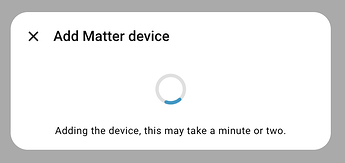

When I try to add Matter or Thread devices using the Home Assistant app on my iPhone (VLAN 10), I initially see “Connecting” followed by “Configuring”. After some time, the process fails with a message saying that the device could not be added.

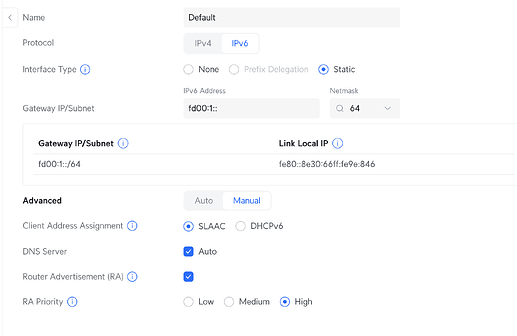

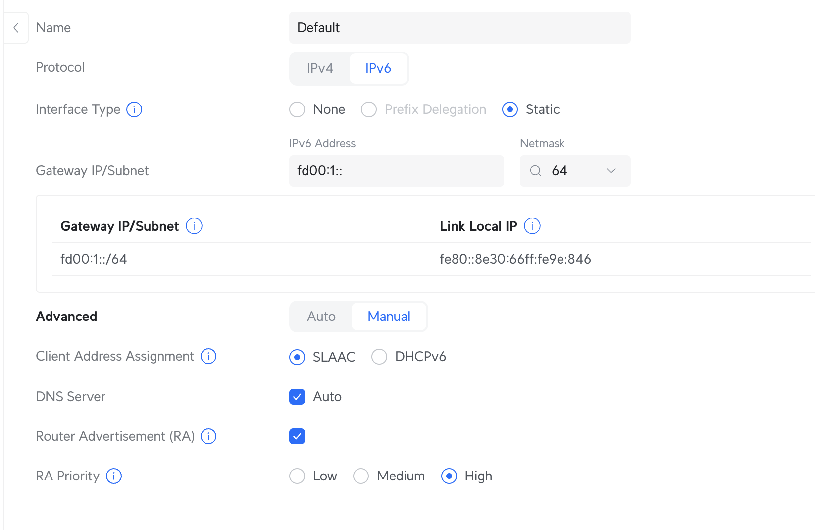

Having different VLAN will not work.I think it’s possible if you know well what to do under unifi to specify rules etc. As I’m new in Unifi, I don’t know already how to achieve this.
The IPs+port can be found under HA - system - network - zeroconf browser.
Under unifi, I disable IGMP snooping which was a game changer for stability.
Under HA, I activate the beta of the Matter server add-on (which is better than python version)
Still no joy here. Just getting a ‘spinning wheel’ trying to add my matter devices.
I have:
Checked the Home Assistant network settings - IPv6 set to automatic.
Applied UniFi IPv6 settings - as posted previously
