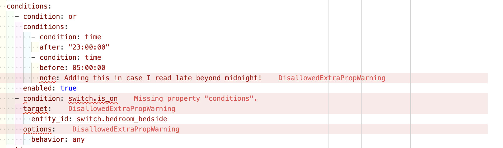

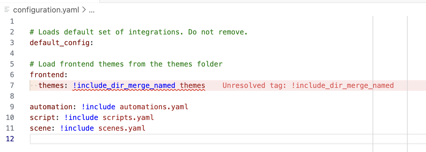

So, I installed the VS Code app, and had a bit of a look-see - and to my dismay I see plenty yaml schema violations in my rather short configuraitons.yaml as well as my automations.yaml! Given that I have never ever touched either YAML file before, I am rather concerned that either the UI does not produce proper yaml as required by the schema, or the schema is outdated, or both, possibly leading to the system breaking and misbehaving at some point.
Some examples below:
Anything to be concerned about?

No, this is known behavior. Just ignore it.
Ok thanks - but that doesn’t help with manually writing good yaml code…
The problem is the home assistant plugin for vs code, this is outdated.
Use another editor, like Blueprint Studio (available in HACS as an integration).
This editor has same functionality as vsc, without the error messages.
