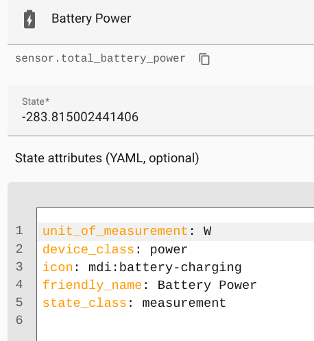

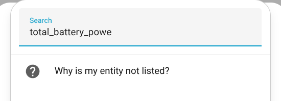

So next question, I have battery energy in and out configured, but when I try to add an entity for battery power, it does not offer the entity that provides that, even though it appears to meet all the criteria:
Is there a FIX ISSUE listed for it in Developer tools → Statistics?
No. However I did go into configuration.yaml and manually added state_class: measurement to the entity there, then reloaded the entire yaml configuration, and that fixed it. It appears adding that in Developer Tools → States doesn’t work, even though it is then listed correctly there.
So two unexpected things - why is state_class: measurement not the default for a sensor (I mean, if it’s not a total of some sort, what else could it be?), and why is there a yaml editor in Developer Tools → States that appears to change the entity configuration but doesn’t?

Yeah that is not a permanent change. It is for testing things like numeric state triggers.
I guess it’s in case you don’t want to fill your recorder with long term stats.
It’s not an editor. It’s a non permanent test tool.
