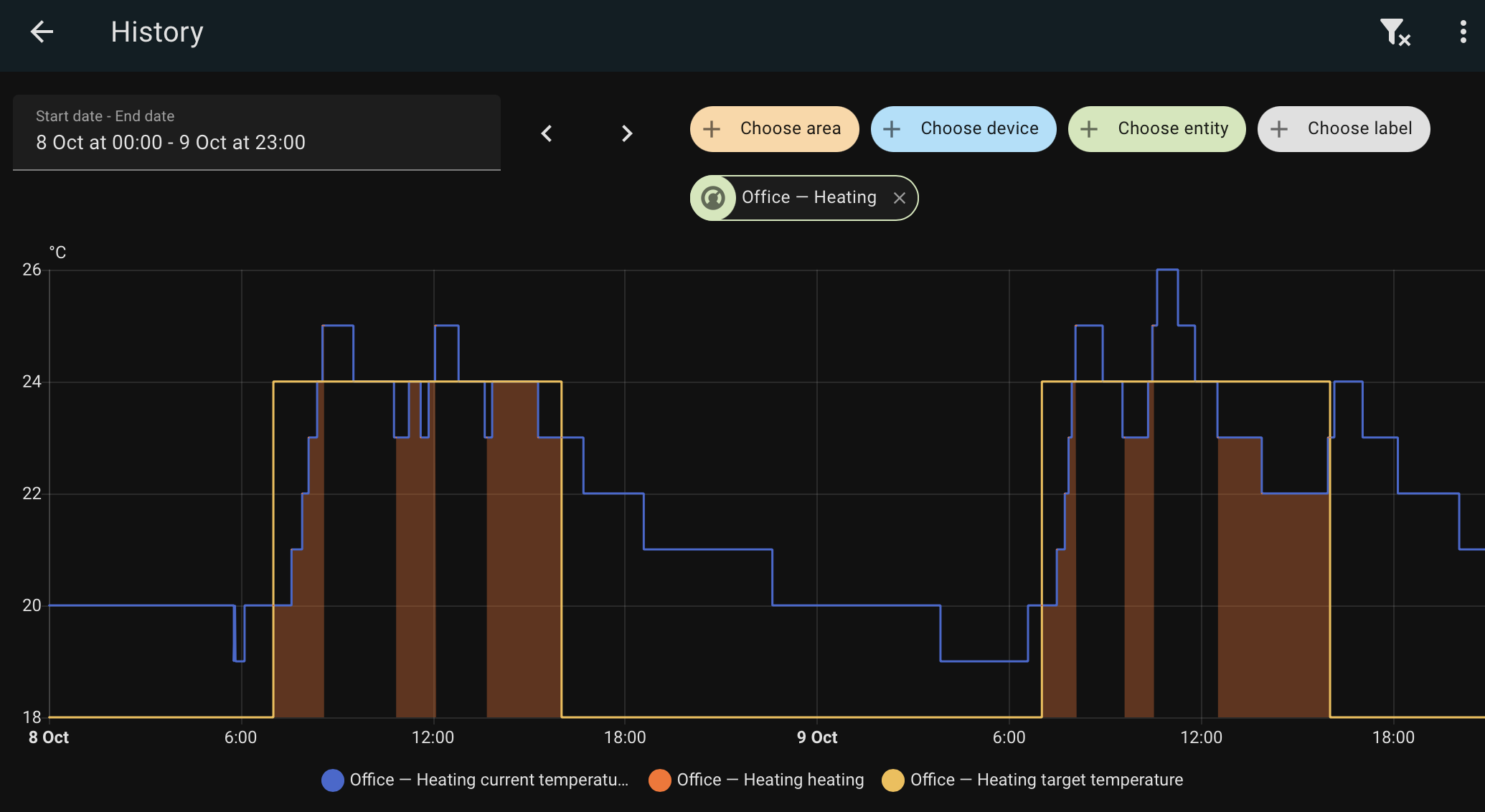

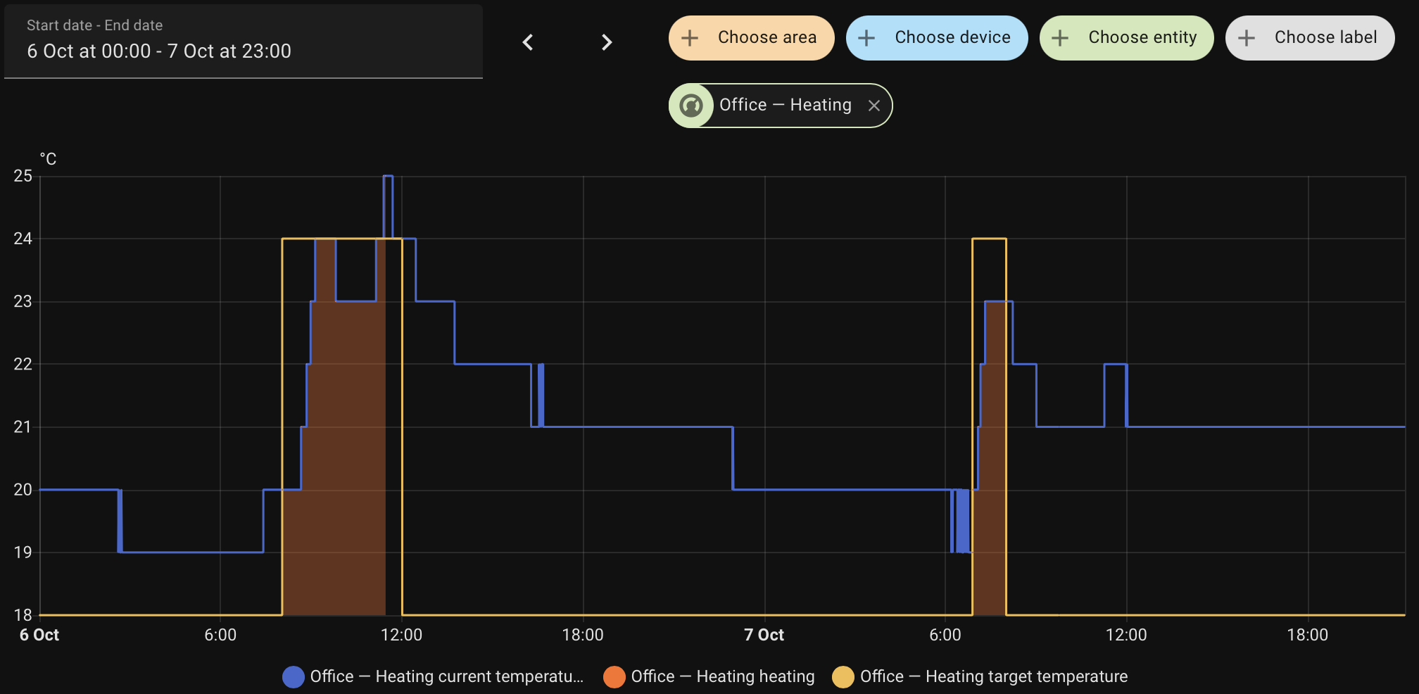

I have the same issue as you. The TRV sets random values, even though it’s configured like this in Zigbee2MQTT: 07:00/24.0 16:00/18.0 16:01/18.0 16:02/18.0 16:03/18.0 16:04/18.0
Here is the graph of last two days. You can see random temperatures.
To work around this, I created an automation (with the help of ChatGPT) that will do the following.
I’ll monitor it for a few days to see if this successfully prevents the TRV from setting random temperatures. Here is the code:

I can confirm now after two days, that automatization (with code above) works as it was expected to work.
