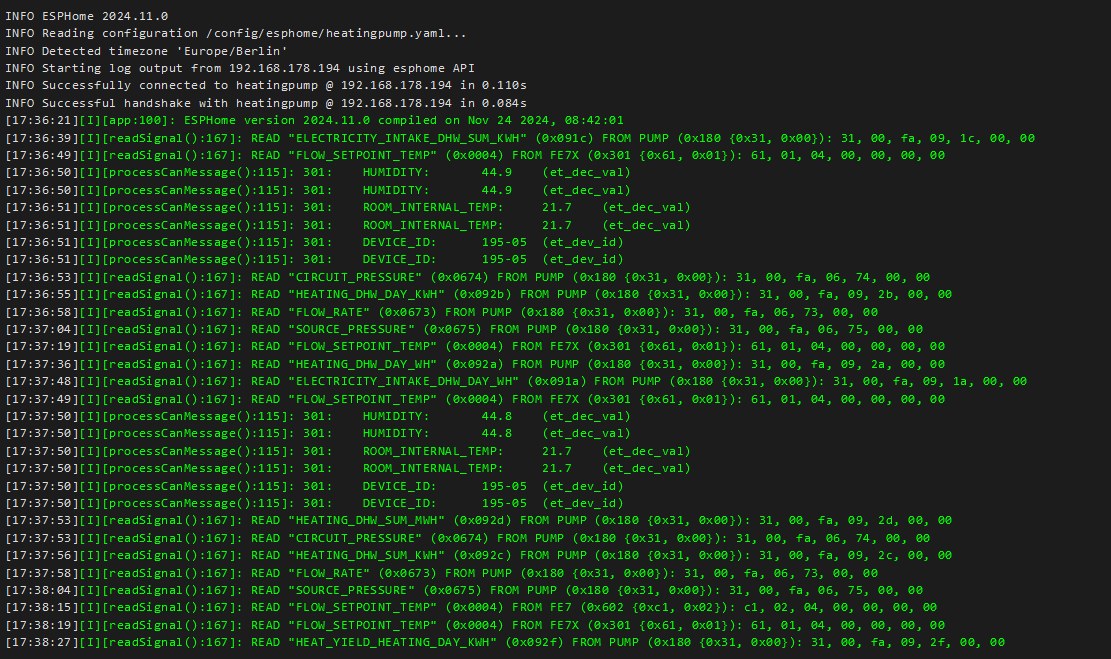

the log shows a lot of messages from 0x180, 0x480 and 0x700 but when i try to send a read request the template.sensor took a long time for a operantion without a response. I really dont know whats going wrong.
I tryed with 680 and 6a2.
I’m sending from: 0x6a2 and read the following IDs from 0x180:
This values like the other statistics are splitted into two adresses. Both are big-endian for me.
0x091f = Verdichter_Leistungsaufnahme_24h_mil all values >1000 for example: 65
0x091e = Verdichter_Leistungsaufnahme_24h_cent all values <1000 for example: 651
result in: 65651 kWh
