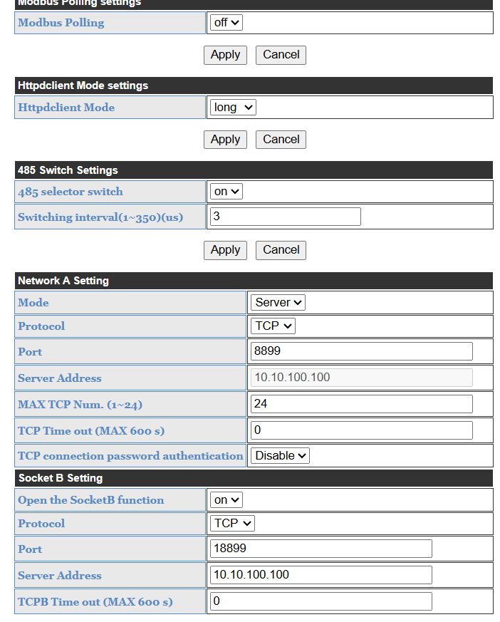

But I wanted to use a Waveshare RS232/485 to wifi eth (b), but don’t get the configuration right. The configuration is different than the screenshots above in this topic, those are other Waveshare devices (mine is black with blue printings).
Can somebody help me a little with the configuration of this device?
I haven’t gotten yet to install all the components, but I’ll also use the waveshare PoE version.
I believe the configuration should be similar.
Post some screenshots of the Waveshare config, as well as the hardware wiring.

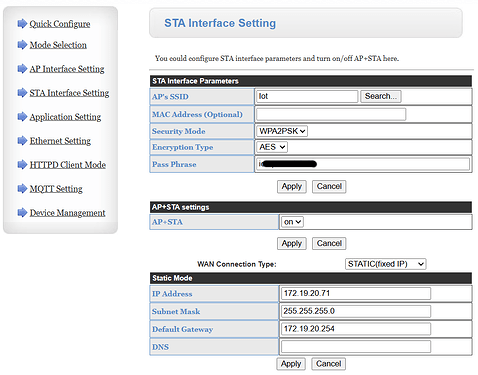

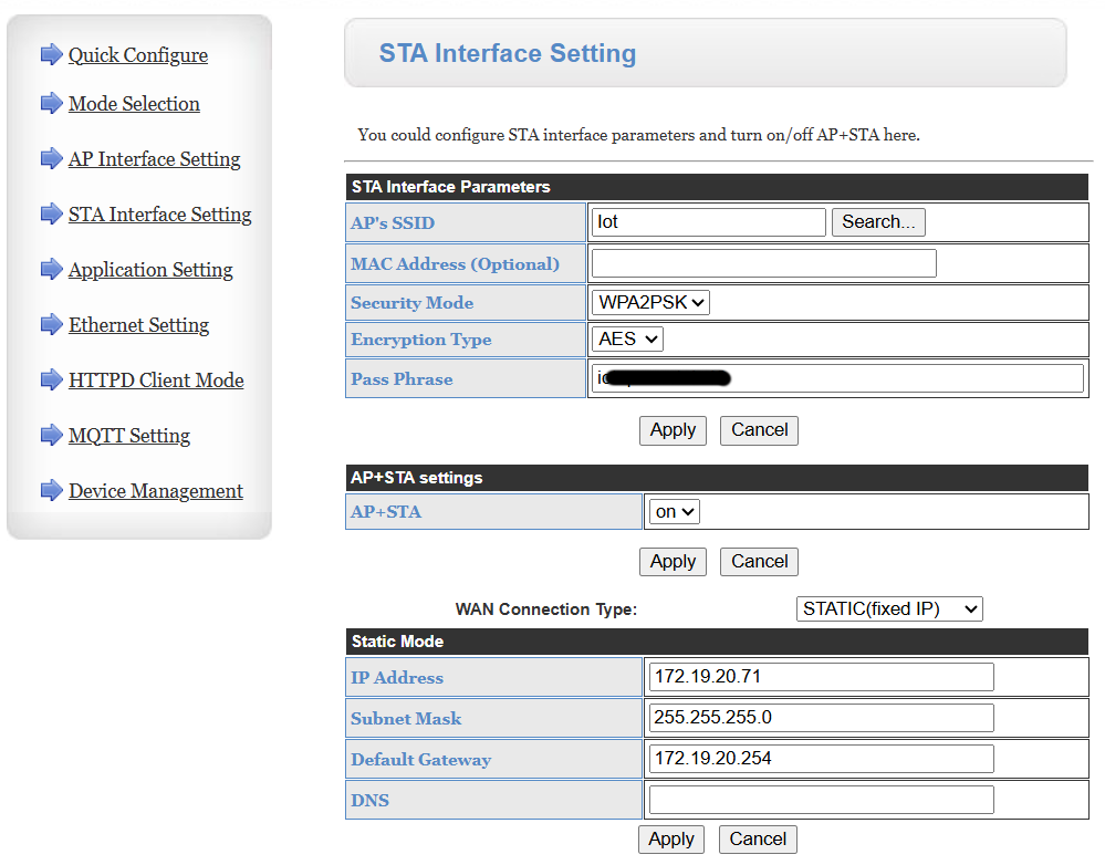

Personally the configuration setup is a little bit strange for me. I’ve configured the device partly.

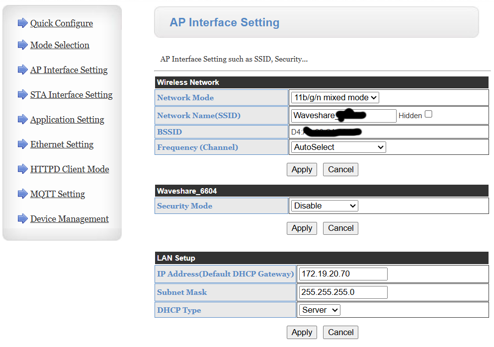

My iot network is in 172.19.20.0/24, and I had configured the device in my DHCP server on it’s MAC address, but that I couldn’t configure, the gateway is 172.19.20.100? That should be 172.19.20.254. I think the Waveshare itself is DHCP server, which should not, only DHCP client device.
So I tried on static, 172.19.20.70. 172.19.1.0/24 is my normal network.
AP Setting is to configure an access point created by Waveshare.
So that’s definitely the wrong setting. Deactivate altogether.

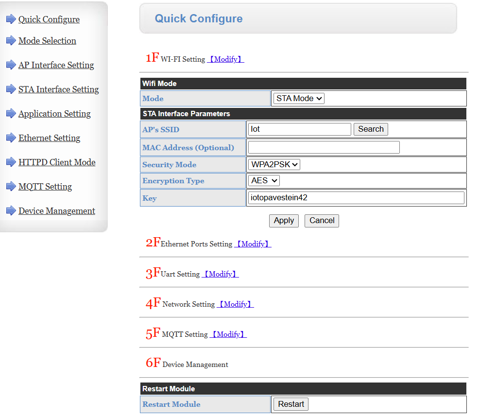

Under Quick Configure, select the right mode.
Not sure what STA stands for, maybe share a screenshot of all options?
Either way, that would be the right place to have the Waveshare connect to your iot wifi.
Under Quick Configure, the other setting is AP Mode, where the device is function as an AP, which I don’t want of course. It has to connect to my iot wifi:

STA mode stands for “station mode”. The device is capable to handel AT commands like a modem.
