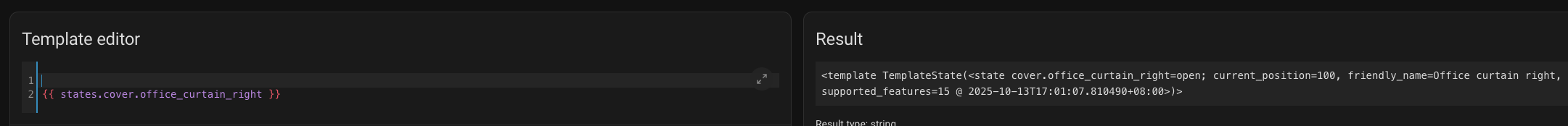

I did notice that it does end up going into the payload state in mqtt at “STOP” but i cant figure out how to access the raw mqtt payload in the automation if conditions?
i tried debugging the device state and it also matches what the interface reflects, its either open or close and never changes to stop
But in the mqtt info for the device i do see it ends up in stop
