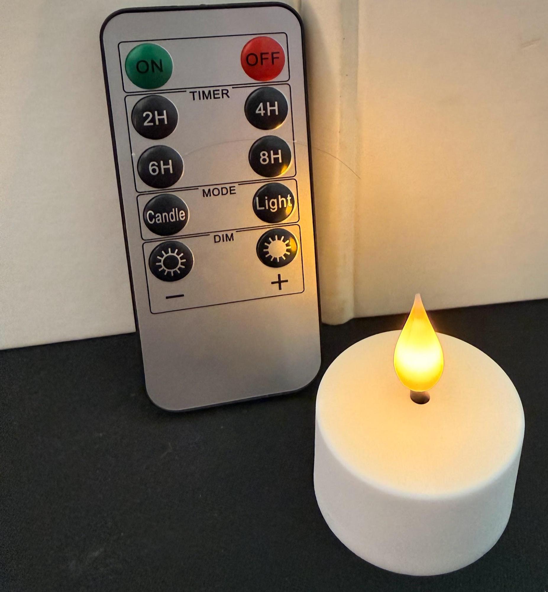

My Scenario: Controlling IR-Enabled Flameless Candles
For this project, I used rechargeable Tea Lights Flameless Candles from Amazon. My goal was to integrate the candles into broader automations—such as a “bathroom ready” routine—to control them via IR through Home Assistant.

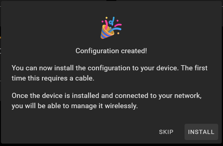

In the Home Assistant ESPHome dashboard, begin by creating a new device.
For the configuration, import the logic from the modified YAML file.

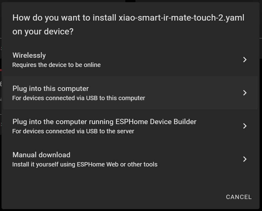

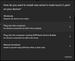

Choose to install the configuration onto your device:
Select the “Plug into this computer” option:

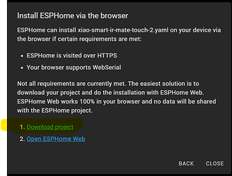

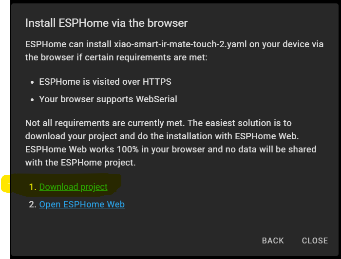

Wait for the project to compile:

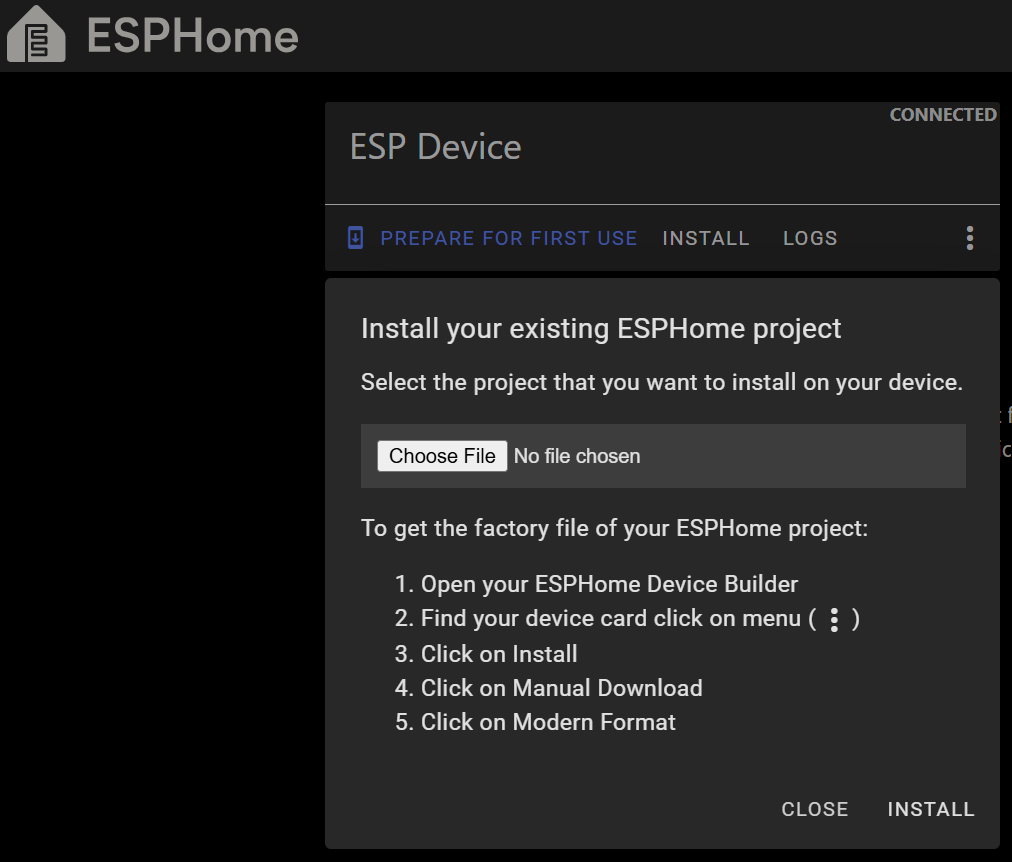

Once the compilation is complete, save the binary file (.bin) and use web.esphome.io to flash it to the device:

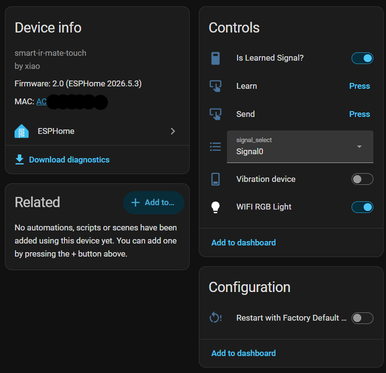

After flashing, the XIAO IR Mate is ready for standard setup; simply follow the wiki instructions. Once completed, the device should appear in your Home Assistant dashboard:

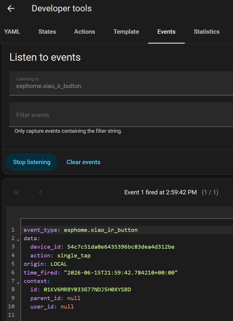

Before building the automation, verify that Home Assistant is successfully receiving signals from the touch sensor:
  1. Navigate to the sidebar and open Developer Tools → Events
  2. Locate the "Listen to events" field and enter esphome.xiao_ir_button
  3. Select Start Listening
  4. Trigger the touch sensor on the XIAO IR Remote
  5. A notification should appear showing action: single_tap
If successful, you should see the event data in the logs:
