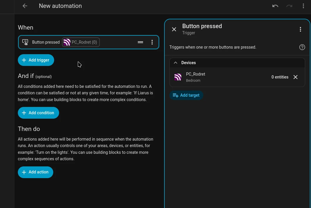

When i go to automations and go to see my rodret i am not sure what i am supposed to do, if i select “button pressed” then select my rodret, there are 0 entities with it, so it doesn’t do anything if i try to use it like that, there is no way for me to add an action or a trigger or something along those lines to detect when i press a button ? i remember setting this up very easily in the past but somehow i manage to get stuck here.
All the youtube videos i watch seem to be from a year or so ago and all of them have a slightly different UI or do not seem to show how to make a simple automation that detects a button press, or i am bad at searching haha.
Here is a screenshot of what i am drying to do:

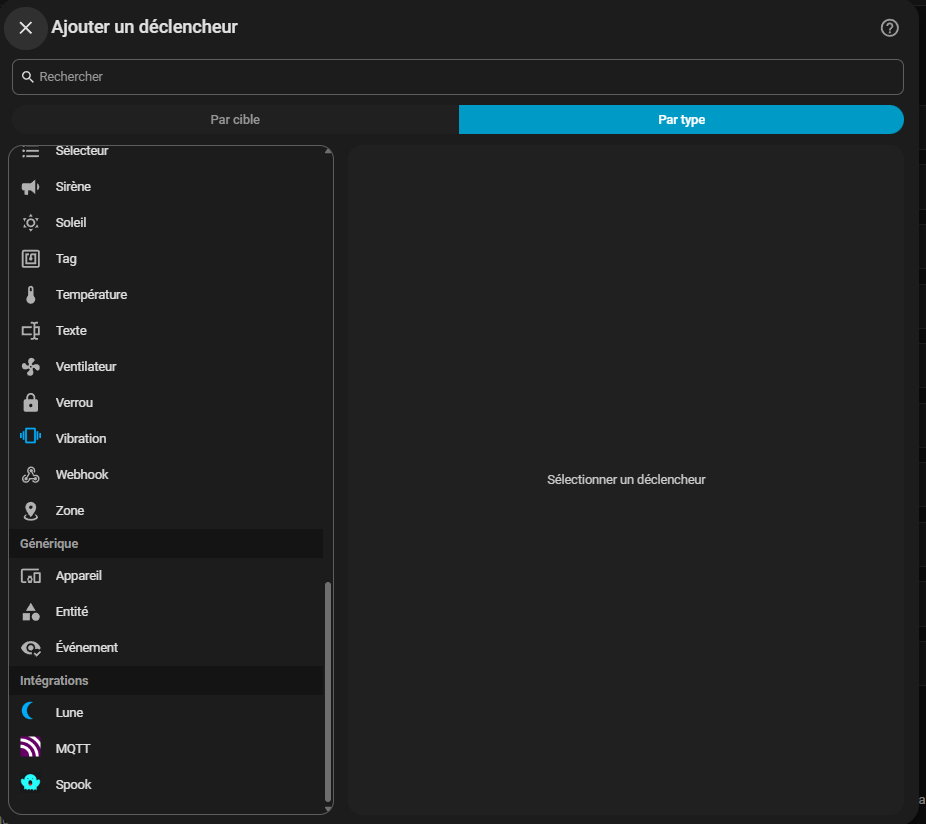

You need to look for your device under the ‘By type’ tab. Right at the bottom, you’ll find a ‘Device’ option :

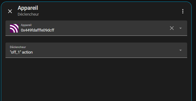

Next, select your device and search for your switch.
The various possible actions should then be displayed. You’ll first need to try all the possible actions (click, double-click, etc.) on your device to make them appear here.
